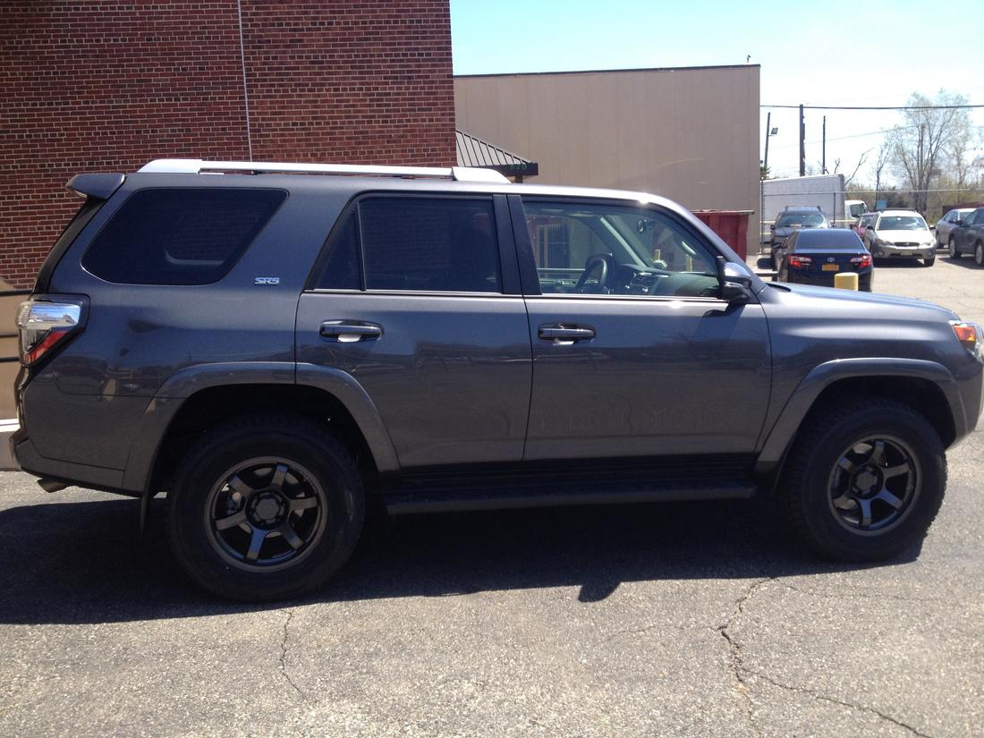

5100's are very popular around this forum. I wanted a little firmer ride, plus .85 on the fronts brought the front to very-near-level. Mission accomplished, great solution.
Up in the stickies is a great link for searching the forum. Volumes have been written on Bilsteins and spacers.
What he said and:
5100s helps the nose dive and with 5100s on all 4 gives better off-road control and feel.
Not much more work than adding spacers.

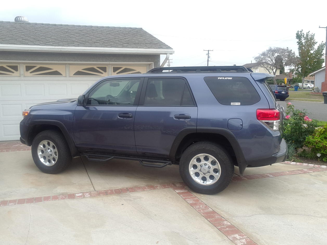

Here's what happened before.....
