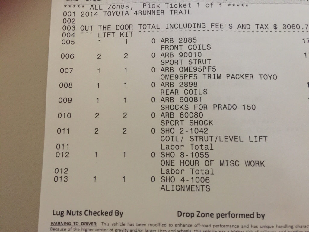

Attached is a pic ( without the tires) of the quote

Need a bit more info. Typically an OME system is around $900. If install and alignment is $500, it should be around $1400 plus tires. If you add UCA's - plan on another $500ish. Install of UCA's as part of a suspension is basically no additional time. Maybe 10 extra minutes or something like that.

The OME part numbers they provided would only be recommended if you plan to add bumpers/skids/sliders. 884 fronts and 889 rear coils are what you would want with a stock vehicle with no added weight.
OME’s will have a stiffer spring than your stock coils, so if you are sensitive to a firmer ride, you may not like them. It will in no way be harsh unless you go with a heavy coil without added weight.

I think that price included installation, tires (who knows how much), and taxes. If the tires are $1000, it's not too far off. If the tires are $600, it's awfully high to me.
Thank you. The tires (4) are $997.24 . No uca's. Which I'm concerned. They mentioned that it's not needed... but, I have found conflicting information on this.

No worries. As far as UCA’s, you will not be able to get within factory alignment specs with a full OME setup without aftermarket UCA’s. With that said, several have gone without UCA’s. It is not a tire wear issue, but it is a drivability issue. You will notice some wandering on the highway with your caster out of spec. With UCA’s, it is an easy add on if you want to add them later though.
