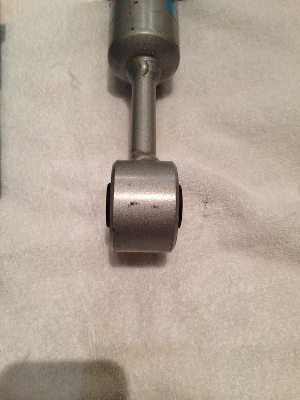

I found someone willing to sell me a set of TRD edition coil overs from a 2014 FJ, cheap. I need to know if it would help me achieve at least a 2 inch lift on my 2003 V8 4runner or if it would even work at all? Fyi, I have xreas. Thank you in advance.
The front shocks will fit if you grind down the bushing to make it flush with the shock (approx. 1/8" on either side).
Also the top bushings on the FJ shocks are wider than the T4R, so the upper body mount would have to be enlarged (you might be able to re-use the T4R bushings, but I haven't confirmed). They won't be a direct bolt on, but they'll fit with some slight modifications.
