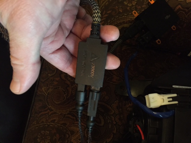

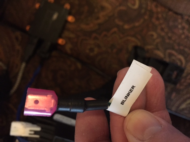

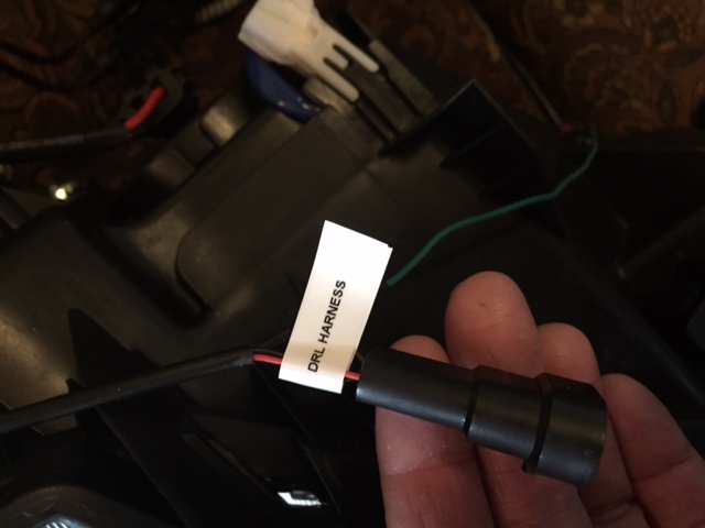

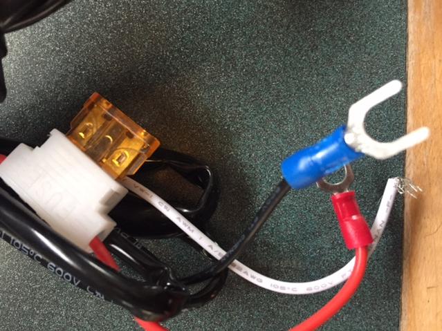

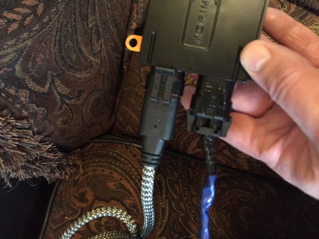

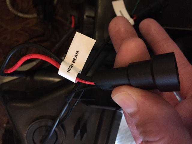

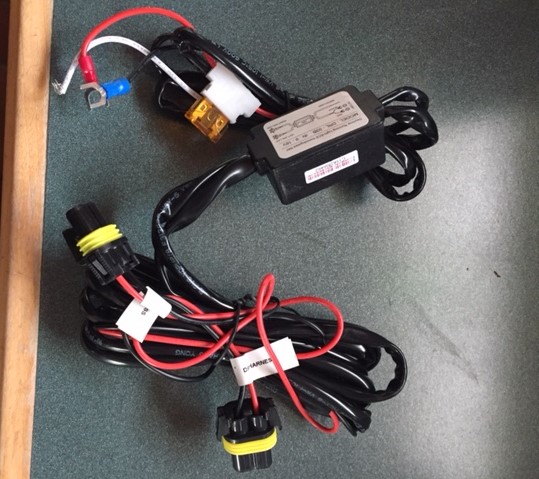

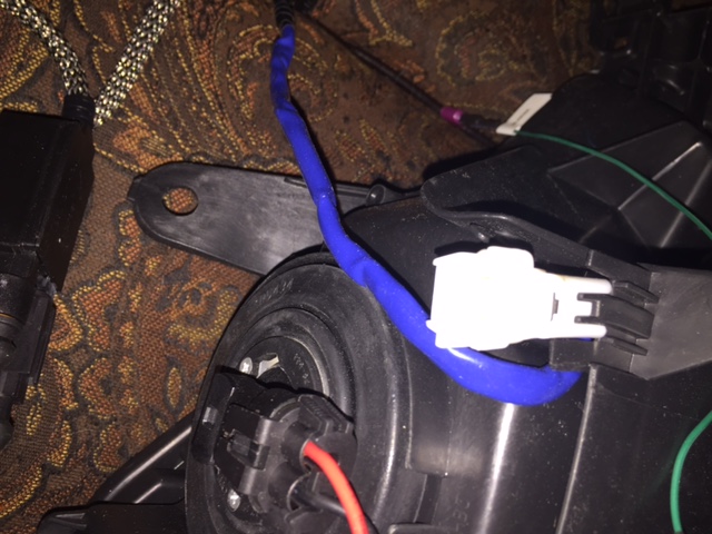

would like some help with installation have no clue when it comes to vehicle wiring the headlights are custom made with a new projector with clear lens and an led switchback as running light and blinker, the headlights are marked what goes where but makes absolutely no sense to me :shrug: and the shops here in the area are total hackers and I don't want the truck f'ed up !

I don't like the Morimoto ballasts because they require an additional igniter. The canbus style do not require this.
Easiest way to do it is to study the connectors on the headlights on your bench and the ones in your truck. Mine is set up battery to ballast, H11 low beam input to ballast, ballast to projector (yours will differ due to the igniter). My high beams are coupled with the DRL because I have bi-xenon projectors, so that goes 9005 input (truck) to a 9005 to 9005/9006 splitter, the splitter then connects to the DRL (9005) and the projector solenoid pigtail (9006).
