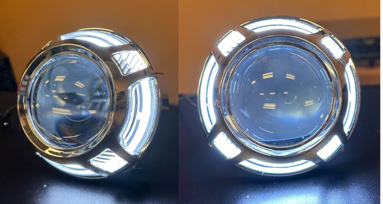

Hello! I'm hoping some of you that have retrofit projector headlights might be able to answer a question for me. I no longer have OEM turn signals after installing an aftermarket bumper and was wondering if the rear rear switchback halos on the LED retrofits are bright enough to function as the vehicle's sole turn signals?
I'm specifically looking at the Panamera 2 shrouds from TEQ Customs as shown below and would be getting them with chrome housings if that matters. I'm assuming that going with front and rear halos would increase the light output but I don't care for how the front halos look (just my personal preference). Any input would be greatly appreciated.

Probably not.
You can wire the corners to do double duty as parking and signal with these modules:
LED Switchback control modules VER.1 (for 1 color LED setup) | PAIR – CorsoMotion
or
Blinker Genie 2 - for Run and Turn with LED Signals on Automobiles – Custom LED
Corsomotion will flash the corners at the same time your halos will, while the Blinker Genie will flash alternately with the halos.
Order these amber 921 LEDs for the corners https://www.ebay.com/itm/3044912643...ar=603515100607&widget_ver=artemis&media=COPY
You could also use this for the corner signal conversion Amazon.com
Connect one of the original parking light + to the converter brake wire and corresponding signal + to converter signals. Cut the 4-pin connector and connect the turn/stop wires to the corresponding parking light bulb +

Oh man, I had those Corsomotion modules bookmarked as a backup plan lol!
I wasn't sure if having the halo and parking light hooked up to the same turn signal wire would cause any problems. Glad to hear it's a viable option and I'll definitely be going that route. Thanks for the suggestion!

Shouldn't be any problems as long as the halo amber is connected before the Corso modules. If you wired them to the Corso outputs they'll be constantly amber with the parking lights. Just be forewarned that Corso isn't the fastest when it comes to processing orders, even their dealers get treated this way LOL
You'll also need load resistors or a LED compatible flasher (preferably)

Good point! I actually bought some cheap Amazon amber LED's strips with adhesive backing and stuck them on the filler plates as a temporary fix. It works pretty well but I'd like something a little cleaner for a long-term solution. I did check out those filler plates from snowbound customs but the individual round LEDs wasn't really working for me aesthetically.
Thanks for the wiring tip! I do have an LED compatible flasher installs so I should be good to go in that regard.

Thanks for the link! I agree they do seem pretty bright but I wonder how noticeable they'd be at a distance with the headlights on. Another user with a similar setup said the yellow rear halos get a bit "washed out" in that scenario so he didn't recommend relying on them as the sole turn signals.

My other concern with using the halos as the sole turn signal is visibility from 90 degrees.
