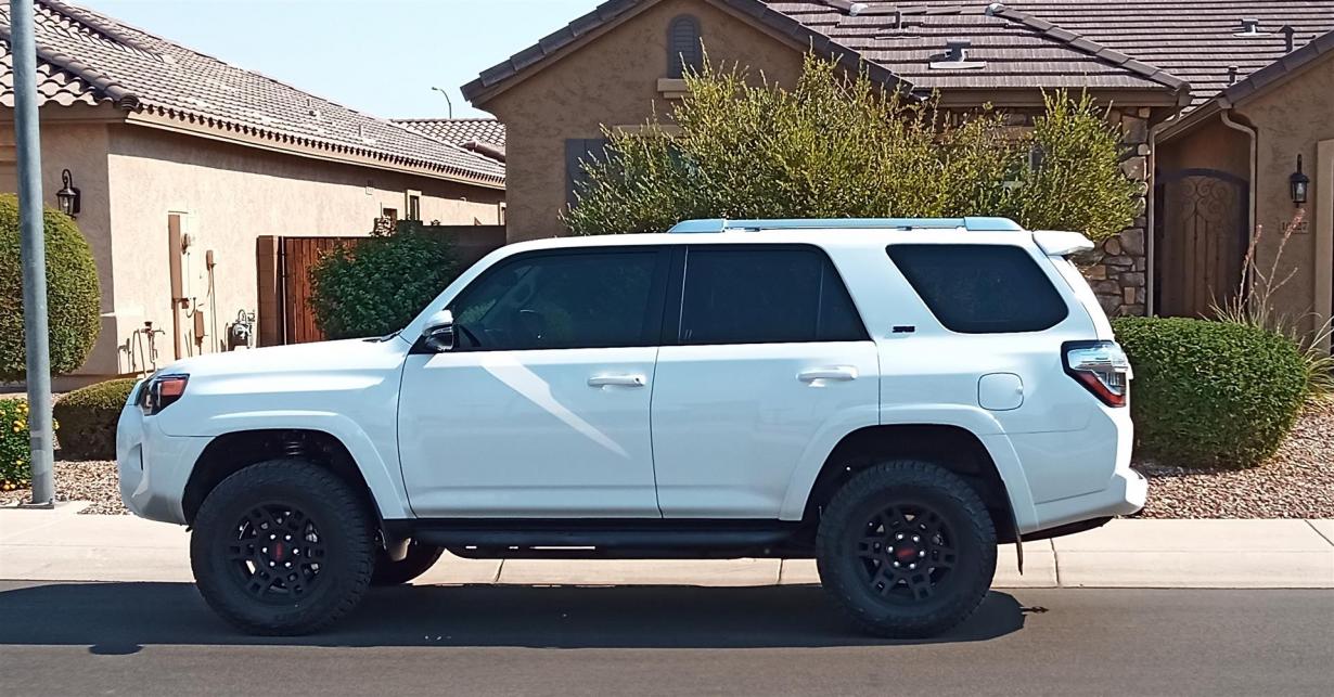

The Eibach ProTruck Kit (shocks & springs, both front & rear) greatly improved the ride, handling & looks of my T4R. Gone is the brake dive and the mushiness, the ride is firm but but hard. Truck has 2.5" lift in front , 1.0" lift in rear.
