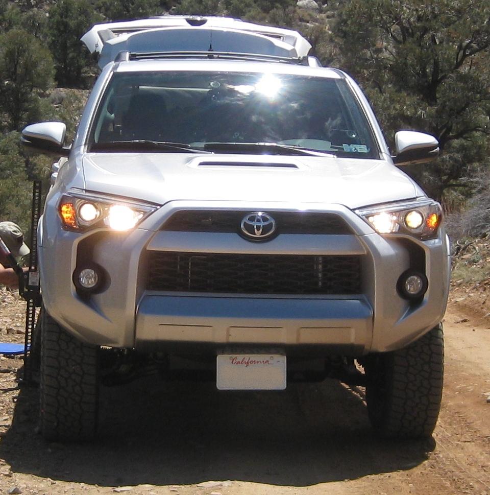

I got a '15 SR5 premium a few weeks ago, and ordered the OEM front plate bracket from TRD Shop. It didn't come with any hardware, so I checked with my local dealer to see how much they'd charge me to put it on, and said it would be $19. So, I figured I'd let the "pros" handle it.
I took it today, and they told me that they couldn't install it without the hardware (they said that the hardware they have for the newer models, the screws aren't long enough).
Any suggestions? I've seen folks mention using self-tapping screws, but am not sure exactly what to go with.

I installed a bull bar. My plate was attached using the dealer plastic mounting bracket on the front bumper (2017 SR5). The plate was attached using the two top holes, and the bottom part of the plate was hidden behind the bull bar. I drilled out two holes on the bottom front of the plastic mounting bracket, and attached the plate using the bottom holes. This raised the plate by 2 inches making it fully visible. Photo here: https://goo.gl/photos/Cv8YdnL18iMBi6Ar6

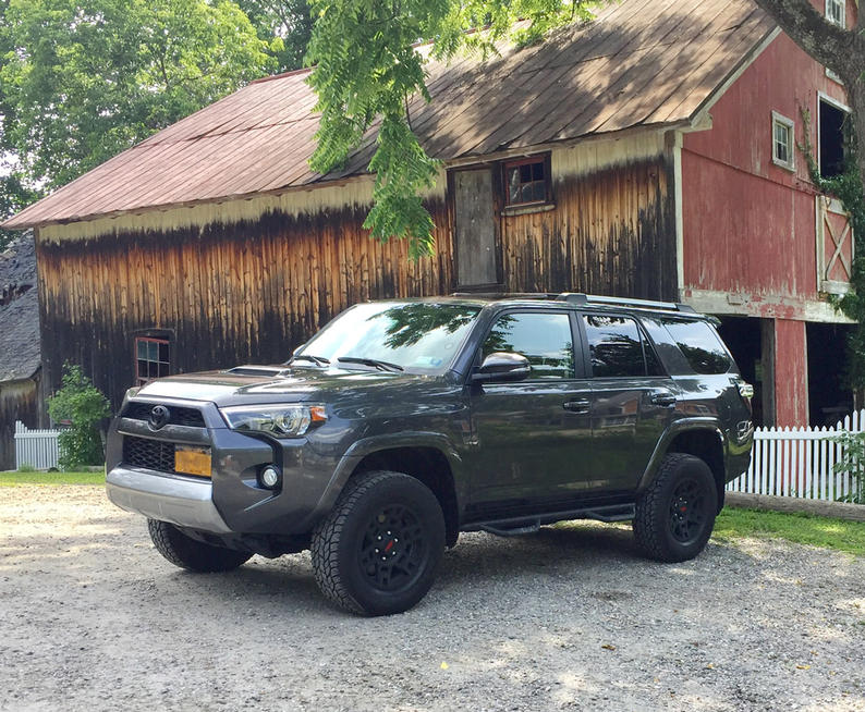

I used 4 stainless bolts with poly washers on each side of the grill with stainless poly nuts & stainless washers on the inside. No drilling at all. Just patience and tape to keep the washers in place.
