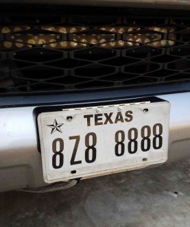

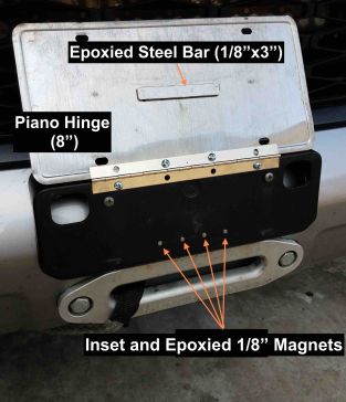

I went with this setup with my undercover winch mount. I like where the plate sits with the original mount plus I have a light bar behind the grill so moving it up wasn't an option.
