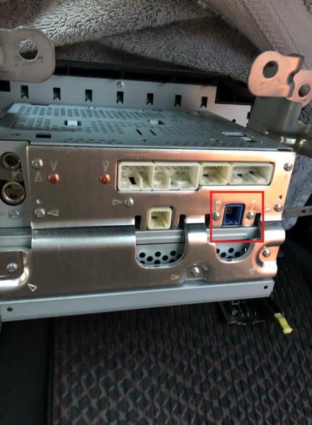

Reason being, there are only 4 factory plugs on the back of the radio. One square blue connector, which I assume has to be the USB connection, has been the most perplexing of the bunch. Have everything else wired up, have ordered BOTH available "USB adapter" harnesses available for "this model year" and neither works?? I even stopped into my local radio car install shop and they said, has to be one of the two, yet here I am with two useless adapters.
Anyone else run into this problem?
Here a pic of my factory unit, the blue connection in the back is what I have to think is the USB connection from the center console..however there's also one in the glove compartment but I don't see the second connection?
rmbertoldi-albums-dear-santa-picture54218-factory-radio-replacement-fun-4-plugs-old-many-many-more-new.jpg
I'm assuming you answered this question by now, but for others that run into this.
The blue connector, single wire is to the antenna for satellite radio.

I'm in the middle of a reset installation. Got half way there and there enough things that I was wishing I had prefinished, paint the Scosche, get the little felt pieces on the stock panel, etc. And 2 items I wanted to think out before tearing into the dash.
1. The USB connector at the bottom of the console. (No. 1 Stereo Jack Adapter Assembly). Looks l like you have to tap in at the Multi-Media Interface ECU*1. This looks like it is under the dash to the right of the glove box. At least when I look up.
Do I have to remove the dash to get to it? Just the glove box? Any tips to get to it???
2. The after marker microphone for the new radio. I saw a few comments of routing it up to the Map Light Assembly next to the stock microphone. Ideally, I like the idea. Taking apart the car, not so much...
Any tips on taking the car apart to route the wire up to the Map Light?
I'm wondering now if I need to tap into that multi-media box on the passenger side to pull those connections..maybe that's where my phantom USB cables are hiding. I would think that once you go aftermarket stereo that multi-media interface loses all it's use..whether for the "Party Mode" button, steering wheel controls, or as multi-channel controller for the factory component system?
The Metra AX-USB-35EXT fits perfectly into the squared spot on the lower part of the console (NO. 1 Stereo Jack Adapter Assembly in your diagram), so if you are having issues, you can plug this adapter directly from the aftermarket radio into the spot used by the OEM one.
As for the microphone, I suggest installing the aftermarket one behind the steering wheel (under the instrument cluster) and check how it goes. It takes only 5 minutes to install it there and you can't see it. Mine is working fine and I don't have any issues with calls nor using the Google Assistant. If it doesn't work, then try routing the cable to the OEM location.
