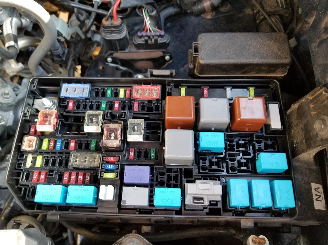

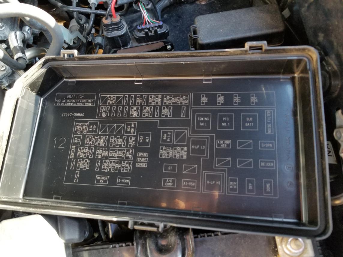

My fuse box has a spot labeled c/opn but no relay installed there and no electrical connection to that spot. From what I'm reading, they did some changes in 2013 when they added the air pump. I guess this relay was moved at that time as well. I appreciate the link, looks like all those manuals are for the 2010 model year. I'm sure a lot of the stuff is similar, but this particular issue is different.
