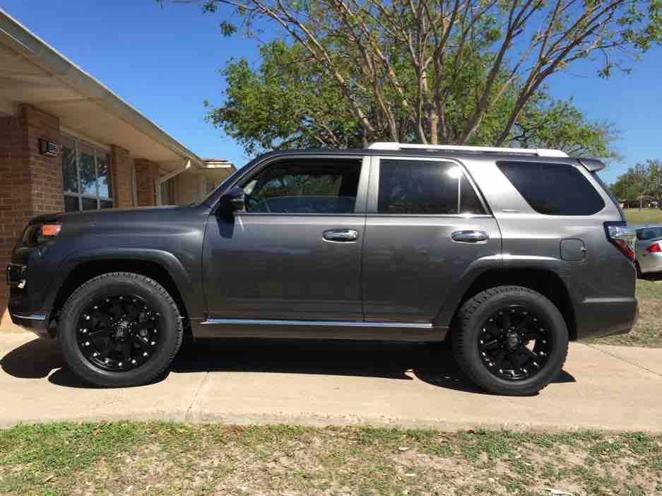

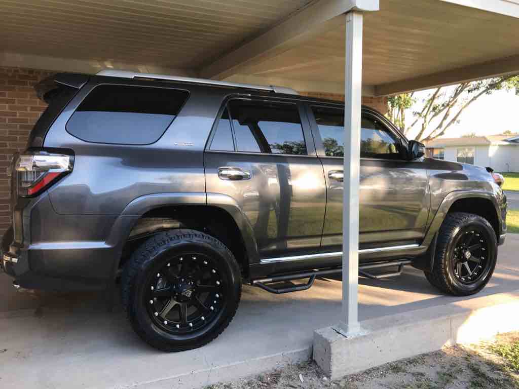

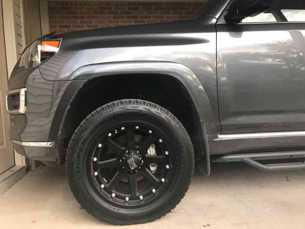

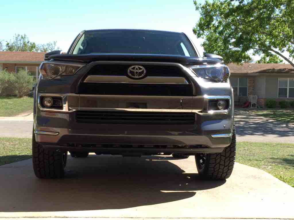

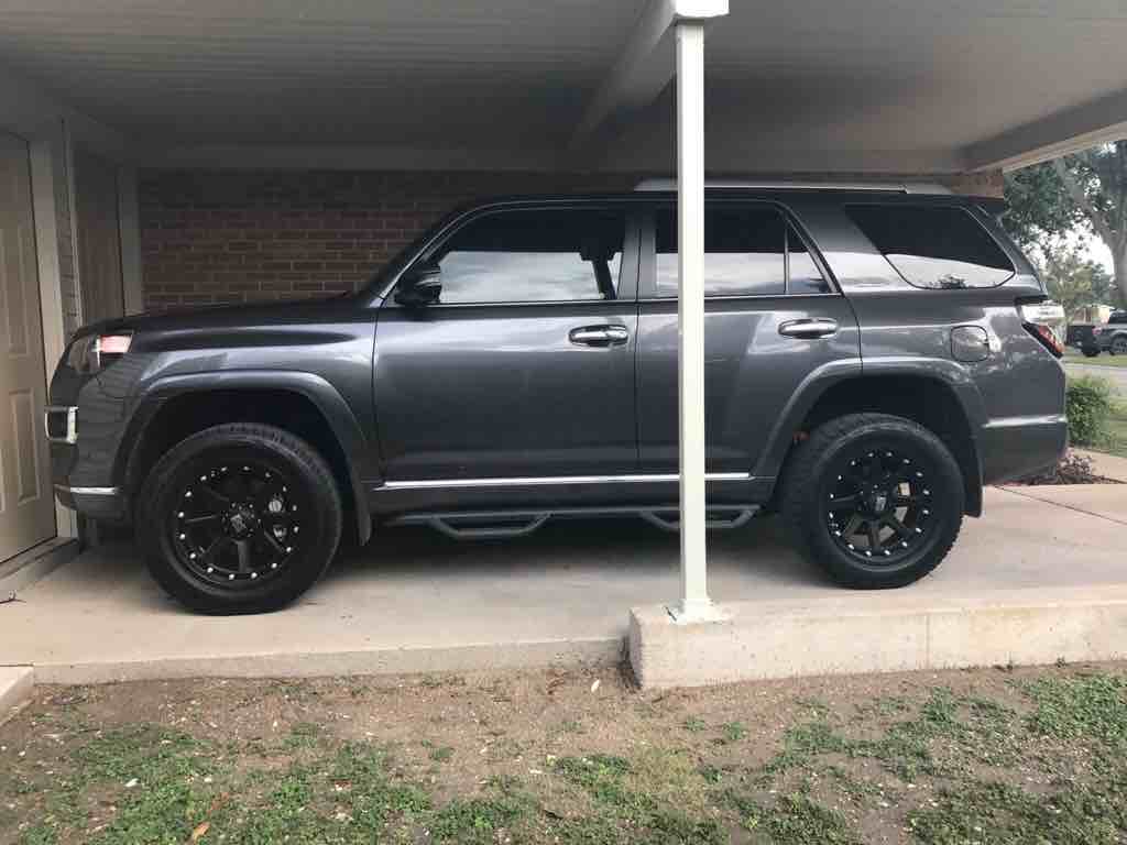

Devildog, no clue on the '16 or '17 but I'm adding a couple pics of my '16 limited with XD rims to maybe assist you on your decision. I replaced mine around 250 miles or so and went with 20", -12 offset to bump them out a bit for a wider stance.
I love the look and ride, but to do this over again I would have gone with 17 or 18" rims. Pushing the tires out caused them to rub a good bit on the front fender liner as well as the mudflap which didn't surprise me.
I did a 2.5/1.5 leveling kit and used a heat gun to mold fender liner and mudflap to prevent rubbing. The leveling kit was in my plans anyway, but was basically a must after I put the rims on. It's mostly on the pavement minus some hunting and fishing, but by no means do I need a real lift for my purposes.
Just wanted to provide you with some additional info before you make the plunge on rims and tires, hope it helps!
Before leveling kit.
After
