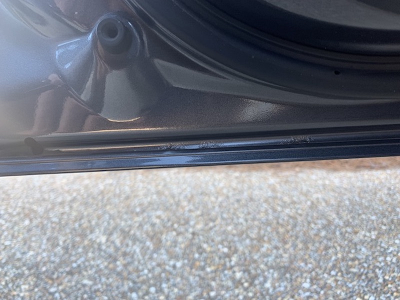

2018 w/Body Rust
I have had two instances of body rust. The driver's side door jam was rusting under the plastic kick plate. Toyota USA fixed it for free. Now my driver's door has rust on the bottom edge along the seam. I wash and dry it regularly and always after a beach trip. Was in VA and moved to NC in the past 6 months. I have sent a message to Toyota and waiting to hear back now.
