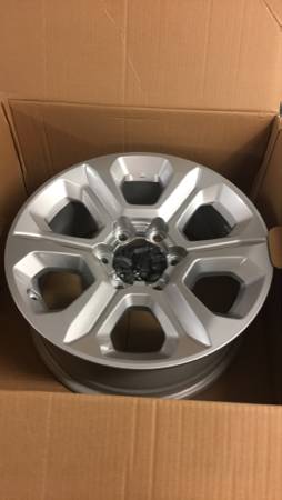

The factory wheels on our 2005 v8 Sport look like hell due to the previous owner having used some harsh cleaning chemicals on them. I have the option to purchase some factory wheels from a 2016 (maybe 2017?) 4Runner at a good price. Has anybody tried to install these wheels on their 4th generation 4Runner?

That is a concern. I need to spend some time researching how it will look. The new ones are much more angular than what we currently have.
If you're worried about the way they look why not plasti-dip or paint them? You could likely have it done professionally cheaper than buying a set. I know the Suburu dealer in Colorado Springs has somebody that puts repair coatings on wheels that seem epoxy tuff and you can't tell there was ever a case to curb rash.

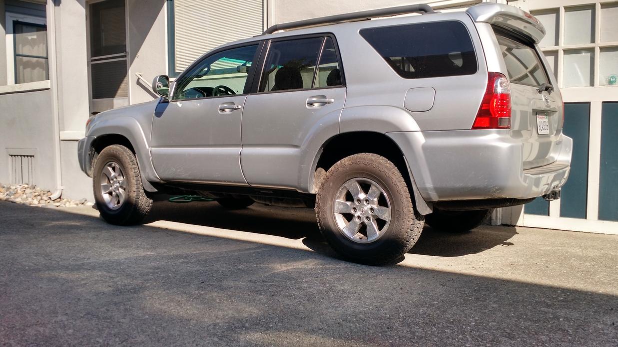

Here is my sisters Sport Edition with those wheels. She bought them as "new take offs" so they have the 265/70 Dunlops on them from the 2016 SR5 they came off of. For reference, her 4Runner is bone stock with no lift. Hope this helps!
There's also the SR5 option as well

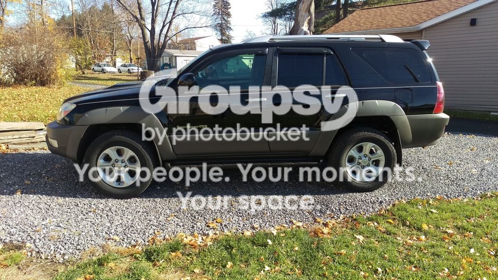

mine are off a 14' with mounted 255/75/17s

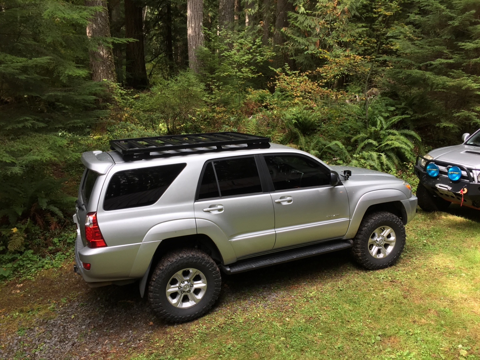

I have those on my 2004. Love them.
Sent from my Pixel 3 using Tapatalk
I am very happy with them on my 03. The added bennifit is that they are spaced out 1/2 inch so you don't need spacers to fit larger tires. I went 265/70 KO 2's but could easily have gone 275's or 255/75's
