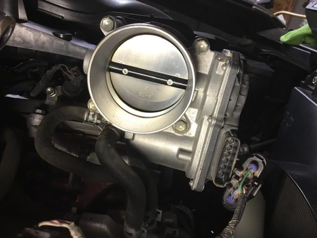

It’s an electric motor that operates the butterfly, and a sensor that reports TB position. You can read the position on a scanner such as a ScanGauge, even with the engine not running.
Expensive part but easy to replace.
Fuel Injection Throttle Body 2203031060 List Price: $403.40
2203031060 - Fuel Injection Throttle Body - Genuine Toyota Part
Would be nice to be able to investigate what went wrong.
If it was common we probably would have heard about it once or twice. Shit happens.

This issue has been reported 3 times on this forum in 2013 and 2015. It's rare. I found posts using this Google search, "5th generation 4runner throttle body issue limp mode" These posts include DTC values and a 2011 TSB.
throttle body problems ..NO POWER
Going on 2nd ECM!!!!
Repeated P2111 Code
T-SB-0092-11 Toyota Technical Service Bulletin
In the second post, ECM was replaced twice and issue was not resolved. Eventually vehicle was fixed when the throttle body was replaced.
When a part is expensive and not covered under warranty, one may always ask for the old part and hold it to confirm the repair. It the repair is not successful, then the diagnostic was a guess and the shop should reinstall the old part and refund the cost. If the repair is successful, then on a part such as this, it would be interesting to test and disassemble to try and figure out what failed.

This happened to me when we first got our 4runner. I picked it up from a dealership about 5 hours from my house and the dealership was closing as I left. I stopped to get something to eat and, as the car was running while I was parked, the engine died and I had a check engine light. I turned the key to the off position and started it back up and everything seemed fine except for an ugly check engine light staring back at me. I drove it all the way home without any issues. The next day I pulled the code (P2111). I cleared the code and it seemed fine for a few days until the engine died again. This time it happened while I was driving in traffic about an hour from home. I was able to limp it into a parking lot and I had my scan tool in the glove box so I was able clear the code and drive it home. I brought it into the dealership right away and they replaced the throttle body. I bought the 4runner with a CPO warranty so it was covered. I asked the service manager if this was a common thing and he told me that it wasn't. It's been almost 2 years and 20,000 miles and I haven't had any other issues.

No mods on mine and it had just been picked up from the dealer with a CPO warranty so I'm assuming the 4runner had a thorough inspection before I bought it. In my case, it seemed like it was just a random failure that probably couldn't have been prevented.
