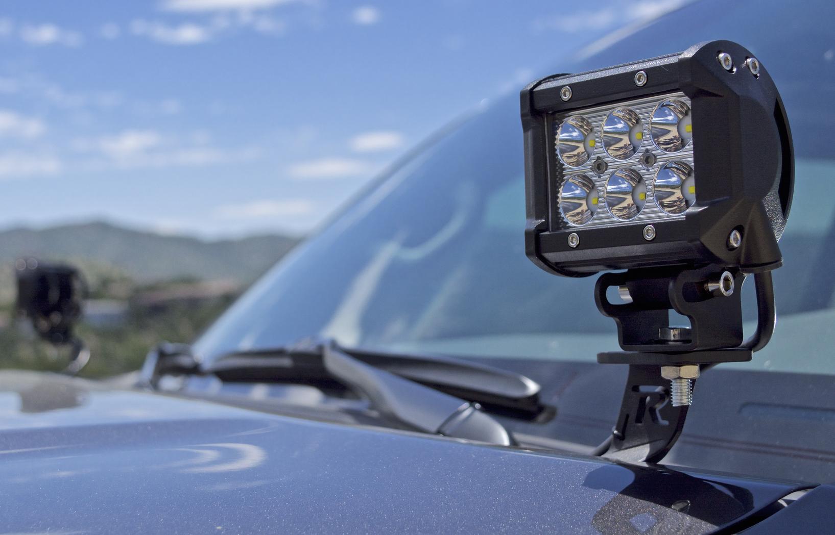

I was in a 4th Gen 4Runner that had the windshield mounted LED light bar and it made a lot of wind noise. Aerodynamically I think this really isn't the best place for a light. I put my 20" LED light behind the upper grill. I also plan on getting another light mounted on whatever full length roof rack I decide on that has a fairing.
Hey there,
I was also told of the wind noise too. It wouldn't bother me, aside from camping, my commutes are extremely short.
They are actually going to send me a 30" bar now instead of a 50" since they don't make them curved anyhow.
If I can get a company to send me a 50" curved bar for my windshield that would be cool!

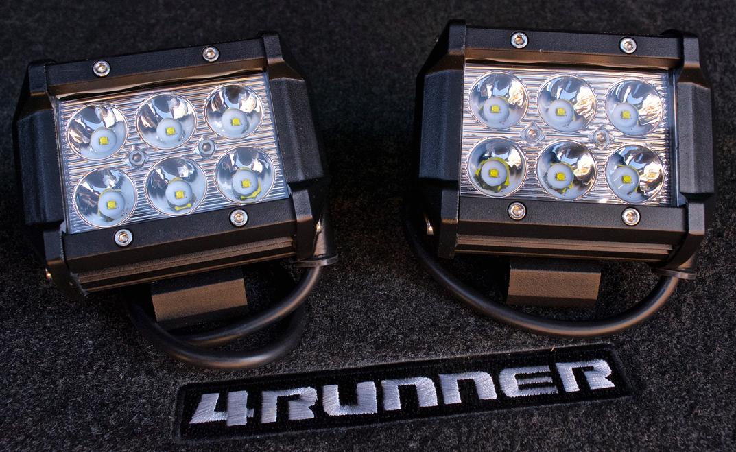

Razir 4" LED ditch light pods arrived
Hey guys, I'm so excited to have received my 4" Razir LED ditch light pods from
from HID Extrta.com
RAZIR 4" Spot LED Off Road / Utility Light Pods (Pair) | HIDeXtra
They seem to be really good quality and construction. I will of course be doing a video install.
here is a photo I just took this morning.
These are only $53 for the pair, free super fast shipping, free returns, great customer service, 1 year warranty. If you don't live in California, you pay no tax!

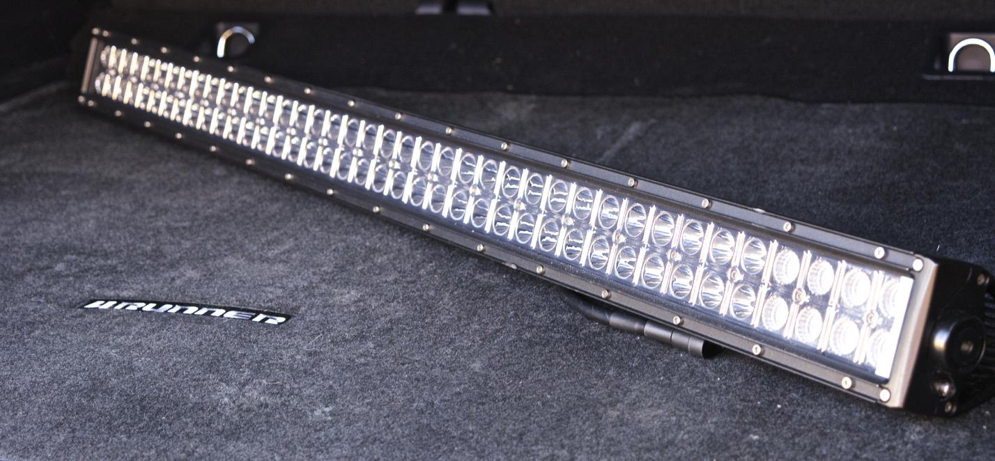

I also just received the 42" bar, stay tuned

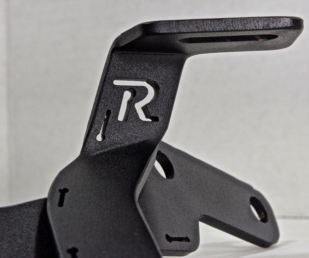

Rago Fabrication Ditch Light Brackets
Hey there, Just in time for my ditch light install., the Rago Fabrication mounts have arrived! they are black powdercoated rolled steel and made in the USA. I must say they are very attractive and so glad to have them on my truck!
In addition to that I also have the 50" windshield brackets and soon to have the 30" bumper/grille brackets too.

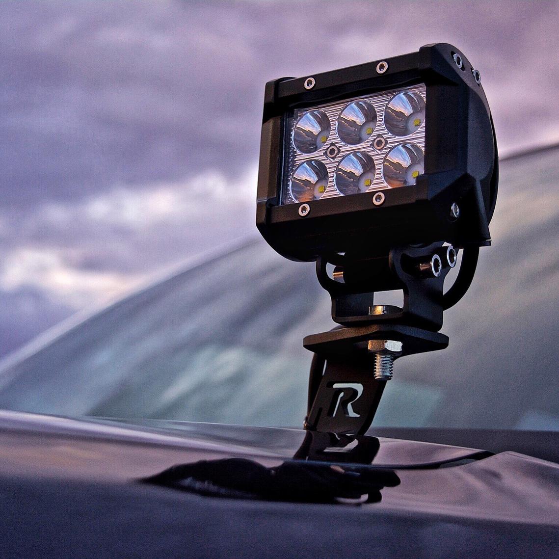

New ditch lights installed
Hey there guys, Just wanted to show you the ditch lights i installed from HID extra.com and the brackets from Rago Fabrication. Video install coming soon!

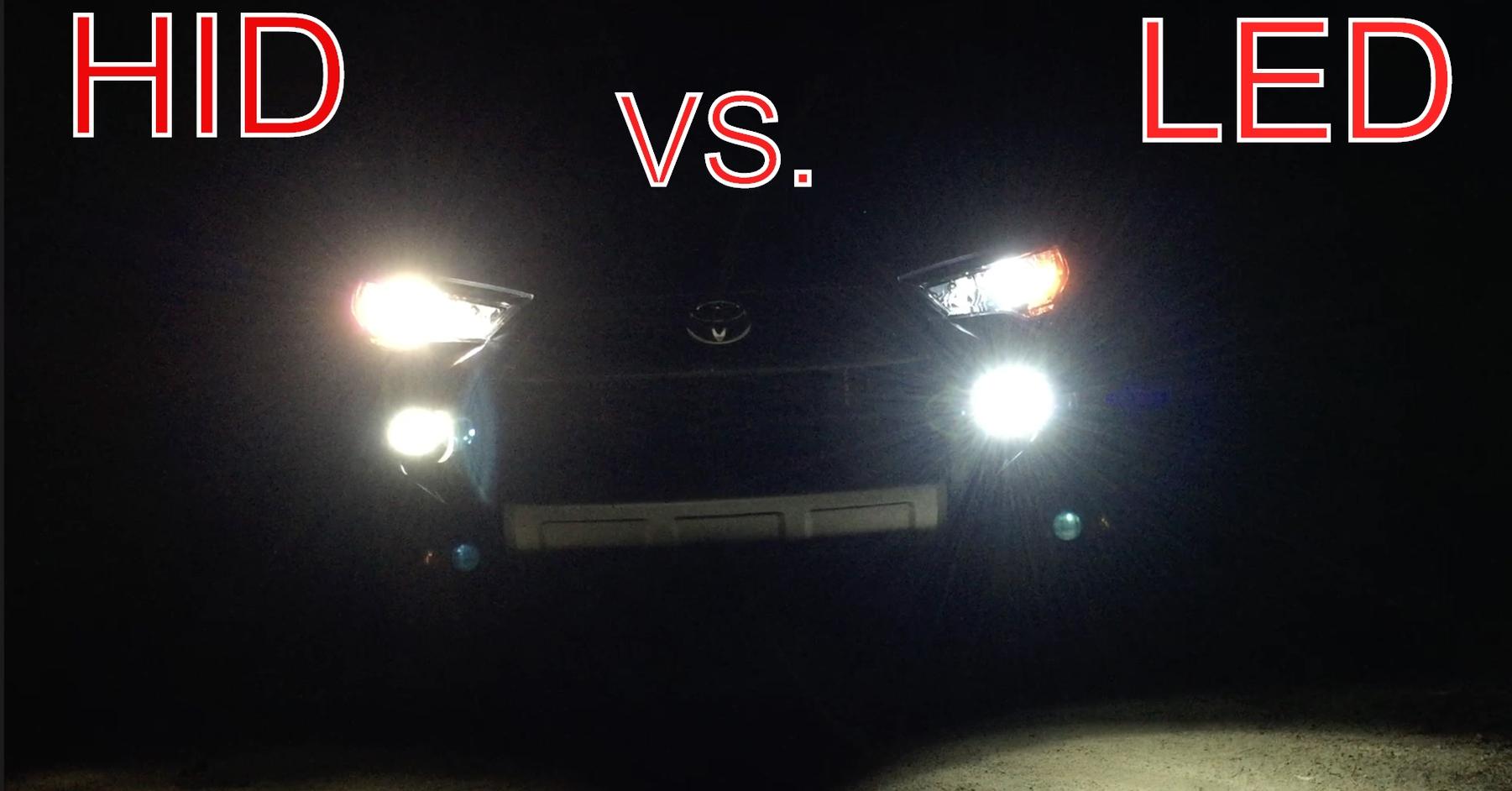

I watched your videos about the Razir LED low beams as well as the video of the LED vs HID comparison. Can you please post pictures (at night) of the comparison of the cutoff from the low beam projector lense? The video was great, but hard to hreally see details of quality and differences in bulbs.
Thanks in advance
great idea
Thanks in advance
Hello and thank you! I will do that, thank you for asking.There is a perfect place to do so nearby also so I should be able to work on that tonight

I just did a video comparison of the Razir LED kits from HID Extra.com and the Xtreme HID kit from Xenon Depot.com in the LOW beams and Fog lights. The results actually surprised me.
I ran the Razir LED units in my low beams for a while and found the left projector tossed out great light while the right projector (passenger side) looked pretty anemic.
I also thought the throw was a lot weaker... the whole setup just felt a lot less bright than even the stock halogens.
I'm putting in a Morimoto HID kit this weekend, so we'll see how that goes.
Did you really fit the wiring harness and everything from the Razirs inside the projector housing so you could close the dust cap?
Thats very strange, mine are very bright, you can see the clip i just put on my instagram. They told me to make sure the diodes faced perpendicular to the ground and not parrallel. Could be defective too. I did get a defective fog light but their service is great. Even sent replacement without me sending anything back. Something is def wrong if the halogens look brighter haha. I did not put all inside the weather cap because I Already had holes from the previous HiD kit. I just have electrical tape covering the gap and seems to be working great.
Yeah, their customer service is awesome.
H11 bulbs will only install one way, right? You can't really re-orient them past where they end up when you insert them and twist to lock.
Yes only one way. However it seems they are an extremely tight fit.
So tight in fact that when I removed one, a prong broke off.
I had to really use some force to get it out. It didnt go in so difficult which is strange. Anyhow. HID actually just sent me a whole new kit! So now I have a an extra one and extra ballasts. They just arrived today and they look great!
It could be incorrectly oriented if a person thinks they met its limit due to it being so tight and hard to get in. The fogs and high beams are incredibly easy to install but the low beams take some work.
I figured out why the LEDs are such a tight fit... The heat sink interferes with a support piece inside the chamber they mount in. A little grinding off of part of that heat sink and they fit MUCH better.
