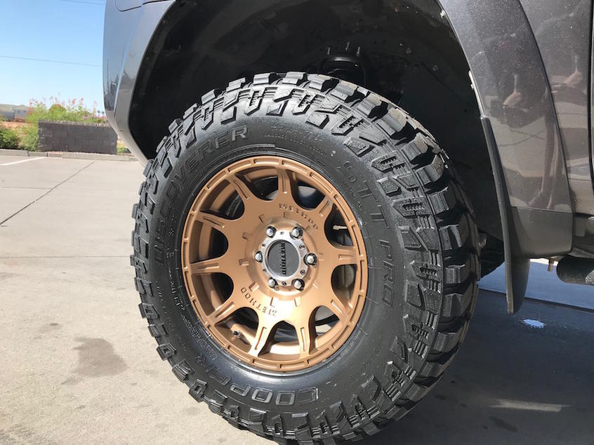

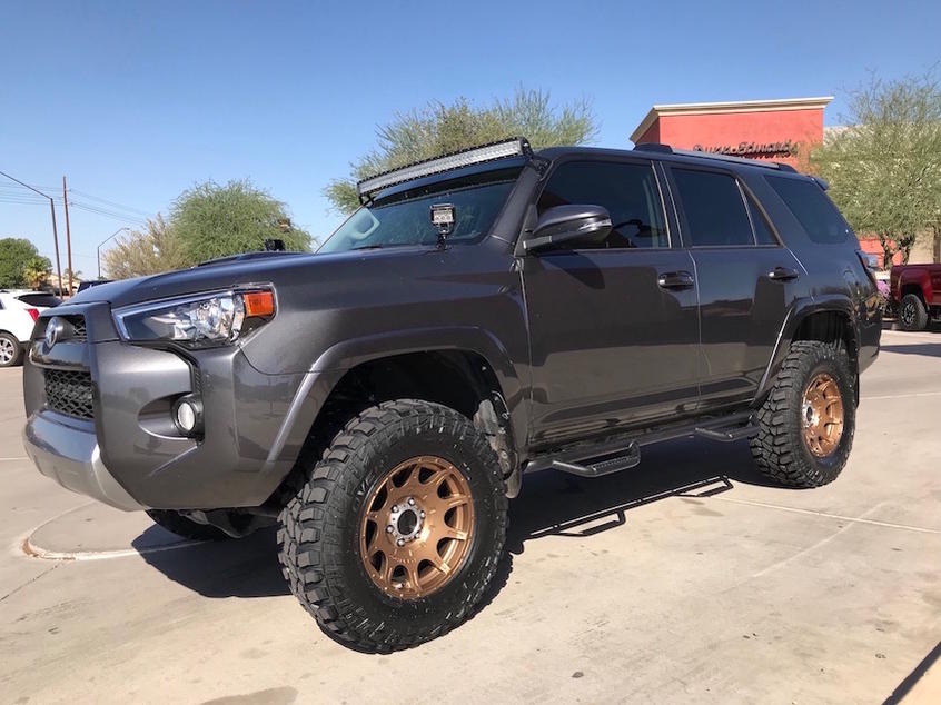

New 3" Lift, Wheels, and Tires!!!
I finally got it done! its been a long time but I finally pulled the trigger and got the Lift, wheels and tires!
The tires are the Cooper STT pro in 285/70/17
The Wheels are the Method Roost in Bronze
The Lift is a 3" Old Man Emu Nitrocharger with toytec spacers in the front to make it level and also added SPC Upper Control Arms. New shocks and springs all around with this lift thanks to Will at Sierra Expeditions in Mesa, AZ.
What do you guys think?
I'm in love with it and I cant stop smiling whenever I look at it. haha. Here are some photos below, I will definitely get some better photos when I can
