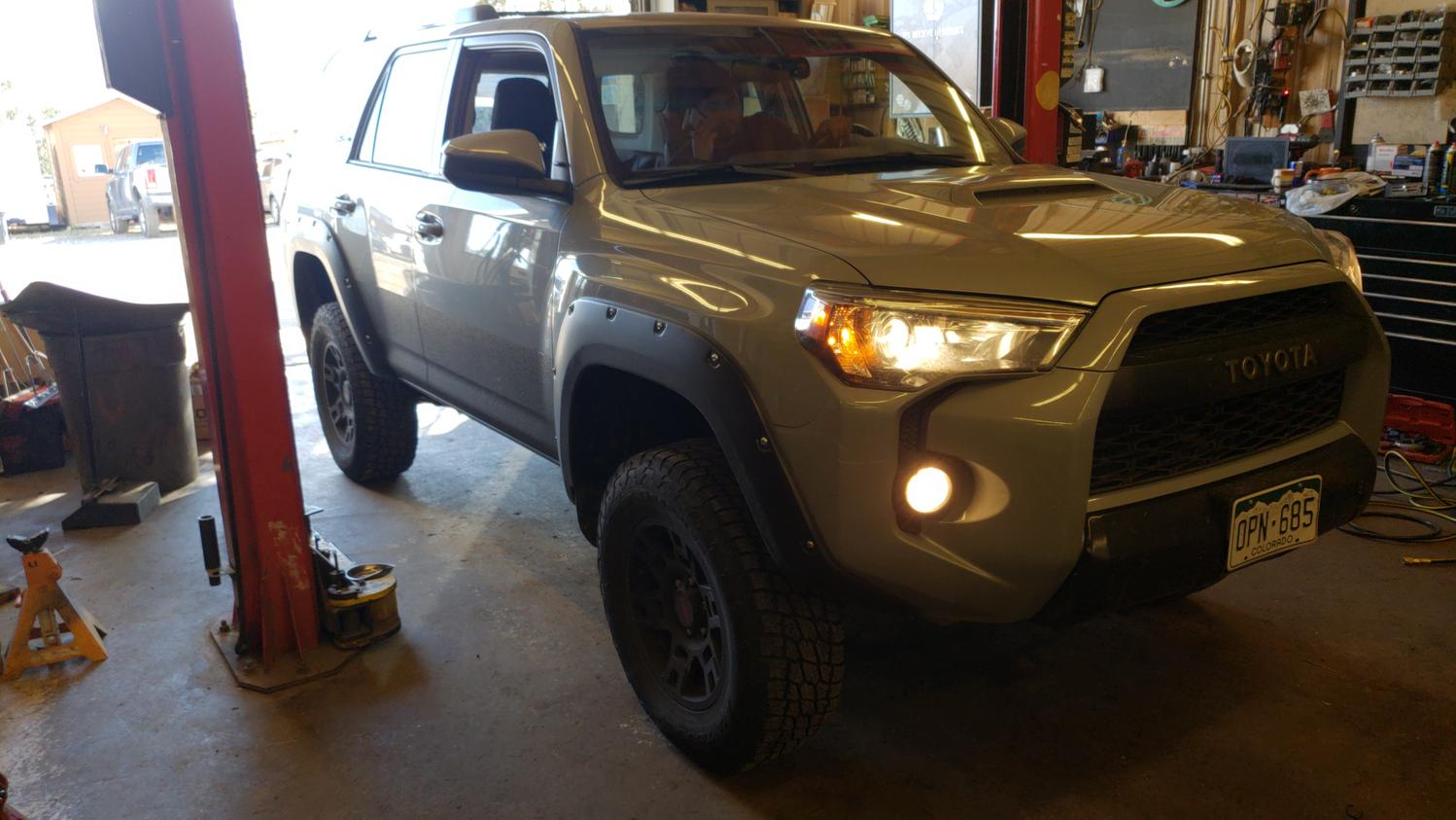

Here's the new fox suspension, now I've got all the trd parts in my hands...
