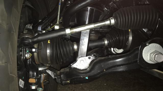

I noticed today that my passenger side inner (closest to the motor) CV boot appeared to be leaking just a little bit. I'm lifted 2.5" with SPC UCA's. The pic I'm posting is of the CV angles on the passenger side when I installed the lift. Most people on here said they looked normal for a 2.5" lift. What are the options on fixing this? Ive heard that re-booting them can be a pain in the a**. Just looking for advice. I don't want to leave it leaking like it is now.

OEM boots are generally the best. The rubber compound is usually most flexible and therefore durable at the steep angles.
What is your center hub to lower fender lip measurements?
Looking at some of your pics that front end seems higher than 2.5 inches of lift.
Do you have a pic of the torn boot?
I'd have Toyota re-boot with OEM boots if the CV itself didn't shit the bed. I bet it would cost around $400.

From what I heard don't bother rebooting, if you're going to take the whole things out just replace it. (Maybe someone more knowledgeable can confirm).
Plenty of posts on folks who have replaced them on their own. Find a friend, get some tools and make an afternoon of it.

Do you have the before and after measurements of your lift. That angle looks like more than 2.5”.

Also your CV angles do not look that severe and I would say average on a lifted 4runner. I think your boot failure is more of the exception and not the rule. Also, the diff drop is not going to gain you much. Now im just rambling...
TO OP: As other have mentioned, CV shaft angle looks like you have a LOT more than 2.5” lift.
I have 2.1 lift on the front and CV shaft is almost perfectly paralleld to the ground….
If the boot is not actually ripped and just leaking from under the clamp (I am assuming from the small clamp) I would try to tie that clamp up -this is what was done on almost all lifted 4th gen 4Runners as small clamp were not able to hold grease if lifted... especially with “excessively” angled CV shaft as yours…

For the CV angle you have, I do not think any brand of CV boot will work reliably and\or better than OEM…

Lifting any of these IFS Toyotas will result in leaking as the stock cv bands are not made to accomodate the angle with a lift. I used these on my FJ, GX, and 100 series and work like a charm. Just replace and never worry about again.
I've got over 215k lifted miles on mine with no problems from the bands. I did wear through a CV boot fin and had to replace the boot on the left outer CV about 40k miles ago, but the bands were still holding strong. IMHO, the Oetiker style clamps are far superior to worm drive, as long as you have the correct size clamp and the proper tool.
