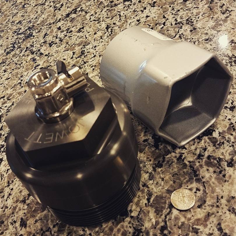

Check out jowett performance. They make a replacement billet oil filter housing.

I own the TOY640 and the Motivx. Both work well but the TOY640 would always get stuck on the filter housing. I would have to pry it off every time I used it. The Motivx has a more loose fit. I actually wish it were a little more snug fitting but not to the point that it gets stuck like the 640.
I have used the Motivx every oil change since purchasing it though.
That used to be my frustration with the TOY640 as well. I’ve since found that a light tap with my ratchet will make it fall right off.
