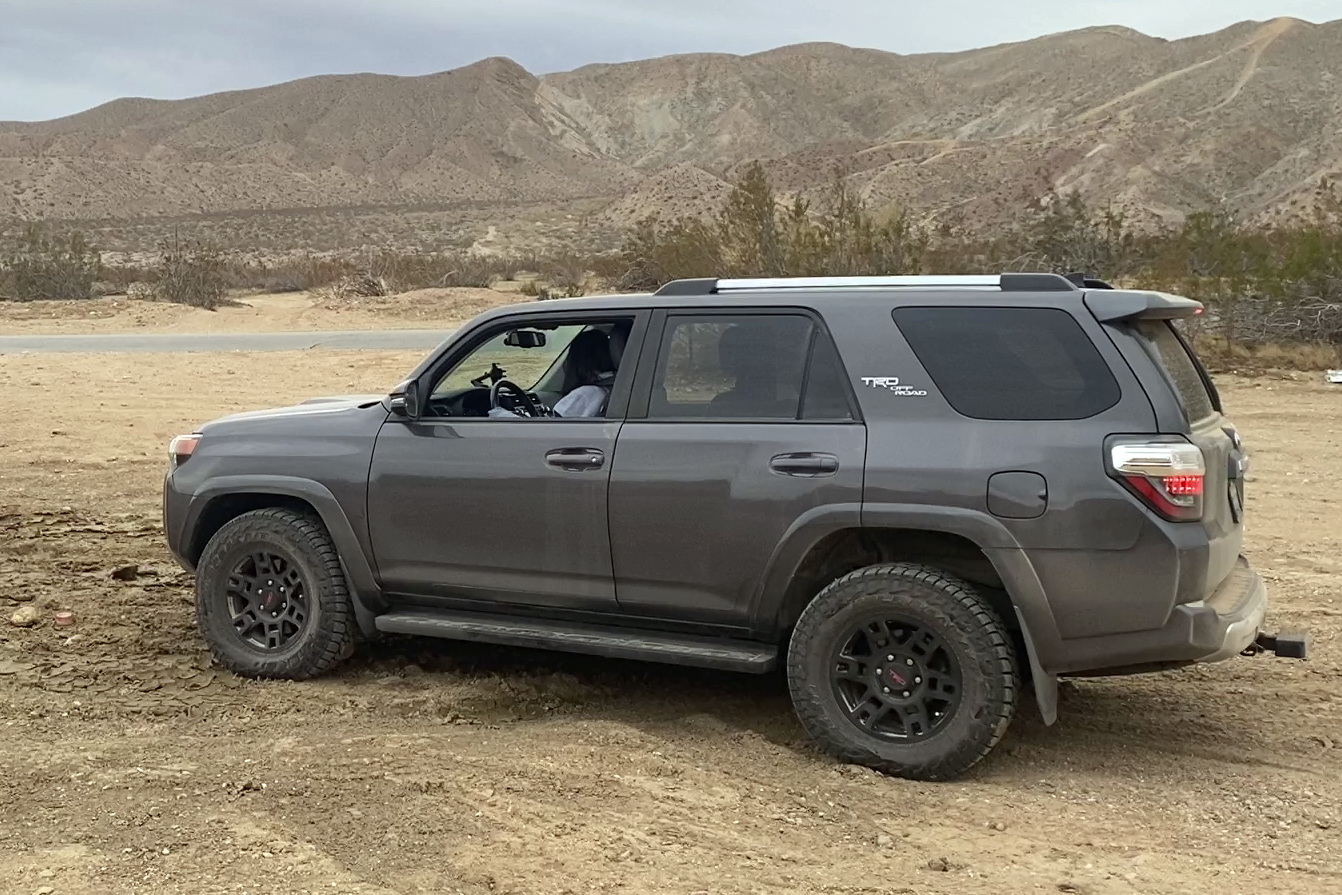

Quick question to the more knowledgeable/experienced peeps in the group... So, I took a 1-day 4x4 class this weekend with my 2018 ORP (all stock BTW except for the tires - AT3W). Majority of my classmates are Jeeps, with only one that is really modified.
When we headed into the trail - man, lots of the bottom gets touched. There was even a slightly rocky trail where I feel that the scrapping the skid plate. But then, I look at the Jeeps in front of me - it looks like they are a bit higher!
I do know that airing down may lose me, say an inch! But even then, I should still have 8.6-inches of clearance, right? Yeah, having 2 adults and 2 kids as passengers may lower it more.
Okay - I would expect the side steps (4R is my wife's daily driver) would be a problem or that overhang in the rear hitch - but those between the tires? I have read that having KDSS lowers it by an additional inch - so, in effect, am only having 7.6-inch of clearance? Am I reading this correctly?
Now, I have headed into a few easy to low medium rated trails before; didn't run into this issue. Albeit, the class may have been a bit more technical than a simple sight-seeing trail.
Maybe time to add some RCI? Or get a lift and bigger tires? Albeit, I really don't need to spend if it is really not that necessary...
Thanks in advanced!!

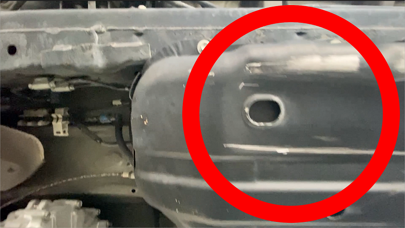

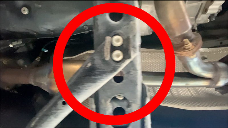

I did a check of the underbody this morning. Skids, well, yeah, lots there... Then this bracket/brace under the driver side (I don't know which part this is) -
and then the rear engine cover assembly -

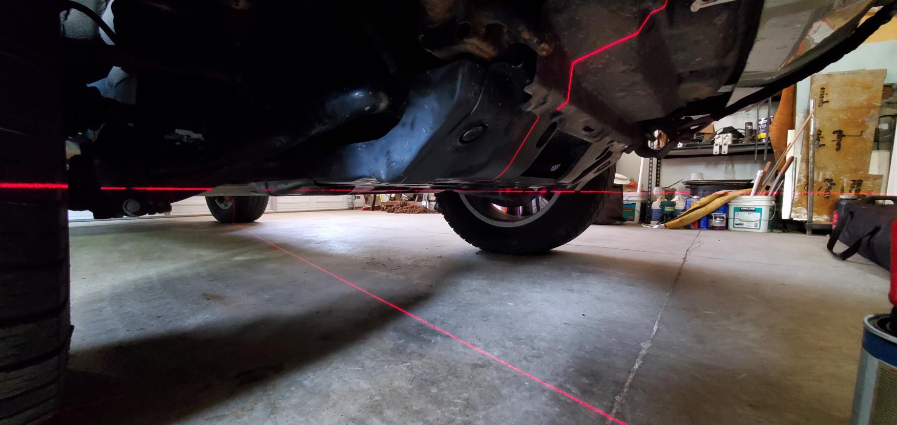

KDSS with OEM skid plate on flat concrete floor with a laser level. KDSS is not the low point. If it lowers ground clearance, there must be more than one version of it. Or some different setup that's changed since mine was made. Because it clearly isn't the low point on my 4runner. The low point in front is the cross member that's the same on all 4runners.

KDSS with OEM skid plate on flat concrete floor with a laser level. KDSS is not the low point. If it lowers ground clearance, there must be more than over version of it. Because it clearly isn't the low point on my 4runner. The low point in front is the cross member that's the same on all 4runners.
