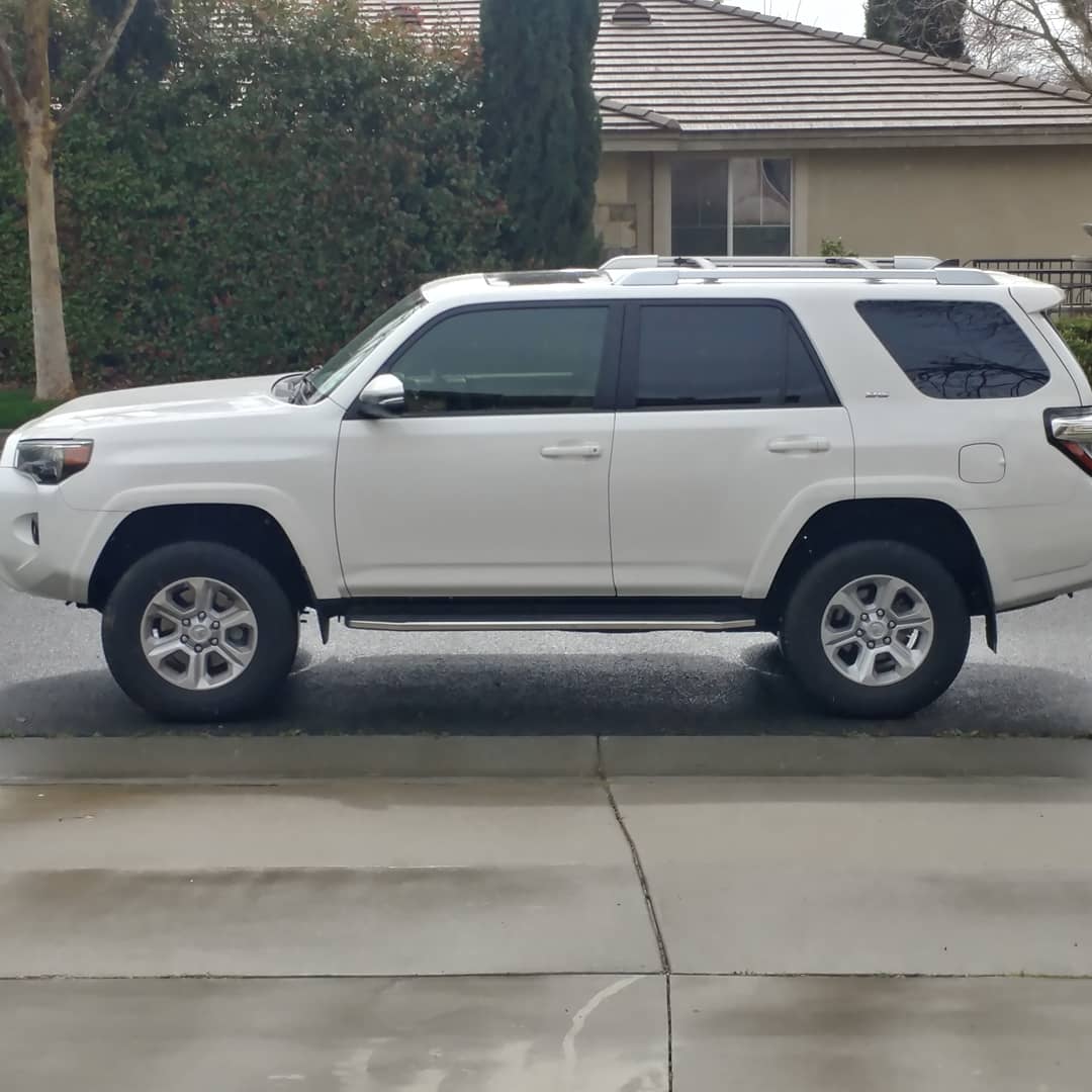

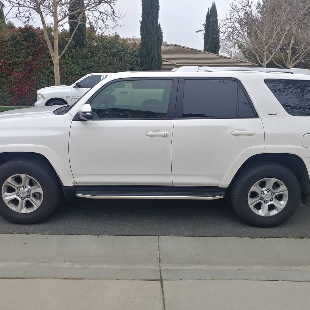

Finished Product
Here is the before and after for my finished product.
[/url]0340FF75-A5FA-4A3A-9853-0C80D9E6AF05 by Tyler Power, on Flickr[/IMG]
And after:
[/url]Untitled by Tyler Power, on Flickr[/IMG]
I decided to go with Bilstein 5100 shocks in all 4 corners. I set the fronts to the highest perch for 2.5" of lift with the stock coils. I used daystar 1.5" spacers in the rear. Those are the stock tires in the picture. Here are my before and after measurements from ground to fender:
Before:
FD: 34.5" FP: 35"
RD: 36-1/8" RP: 36-7/8"
After:
FD: 38" FP: 38"
RD: 38" RD: 38"
We did the install ourselves, and it is completely doable. If anyone has any questions about it let me know.
