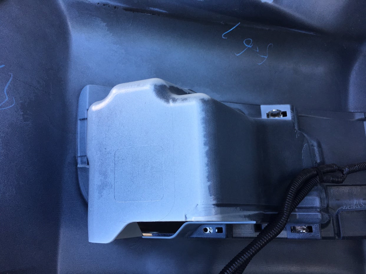

I’m trying to replace my fog lights with OEM LEDs. I’m working on the driver’s side and I can’t seem to get this cover off. Any ideas?
Actually the more I look at the the more it looks like the housing comes out from the front. Is this right? It seems impossible to remove from the fender side.
So next question, is it possible to remove the bezel without having to remove the entire front bumper. Im beginning to thing I need to remove the front end but would prefer to not have to do this..

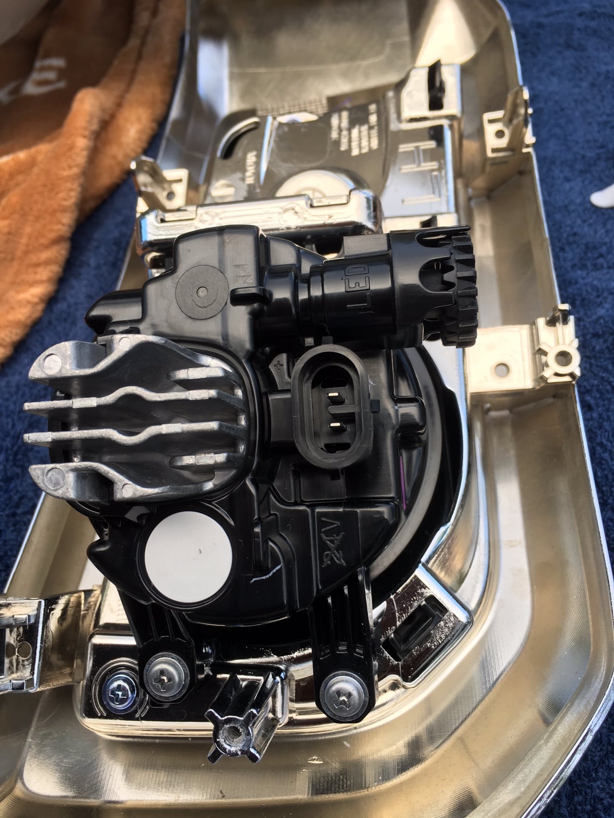

Just pull on it, it will come off. There’s supposed to be a tab that you can depress with a screw driver. I just pulled mine. The housing has to come in from the back. There’s some tabs and a couple of screws.

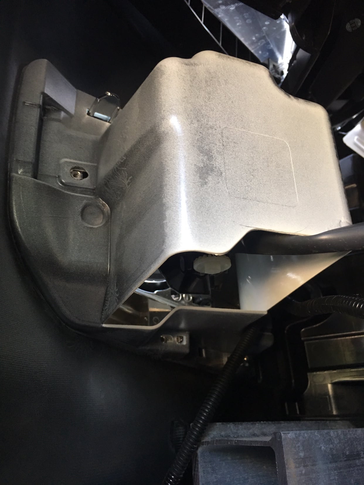

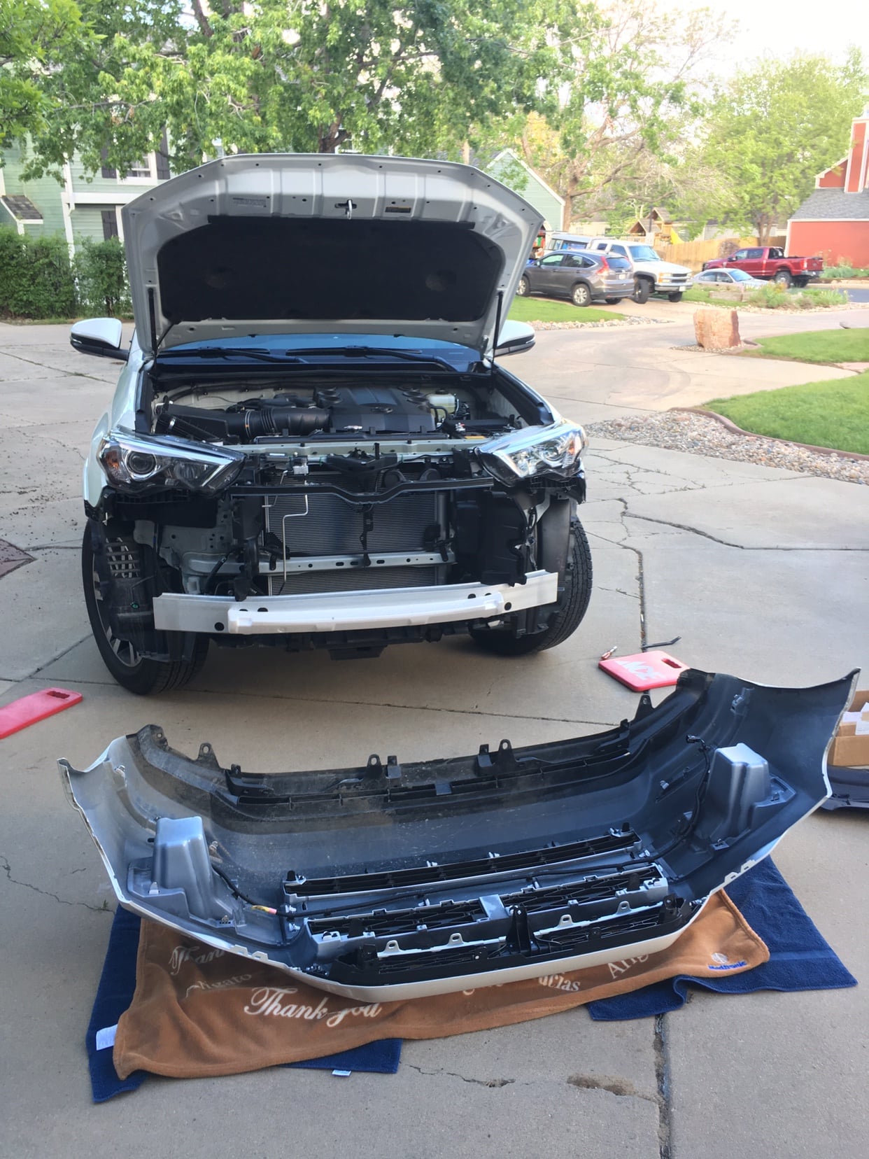

Mine’s a 2019. I ended up pulling the entire front. Hardest part was disconnecting the parking sensors. [emoji38]
I finally got access.

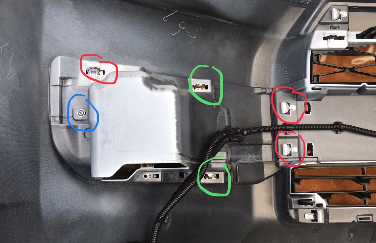

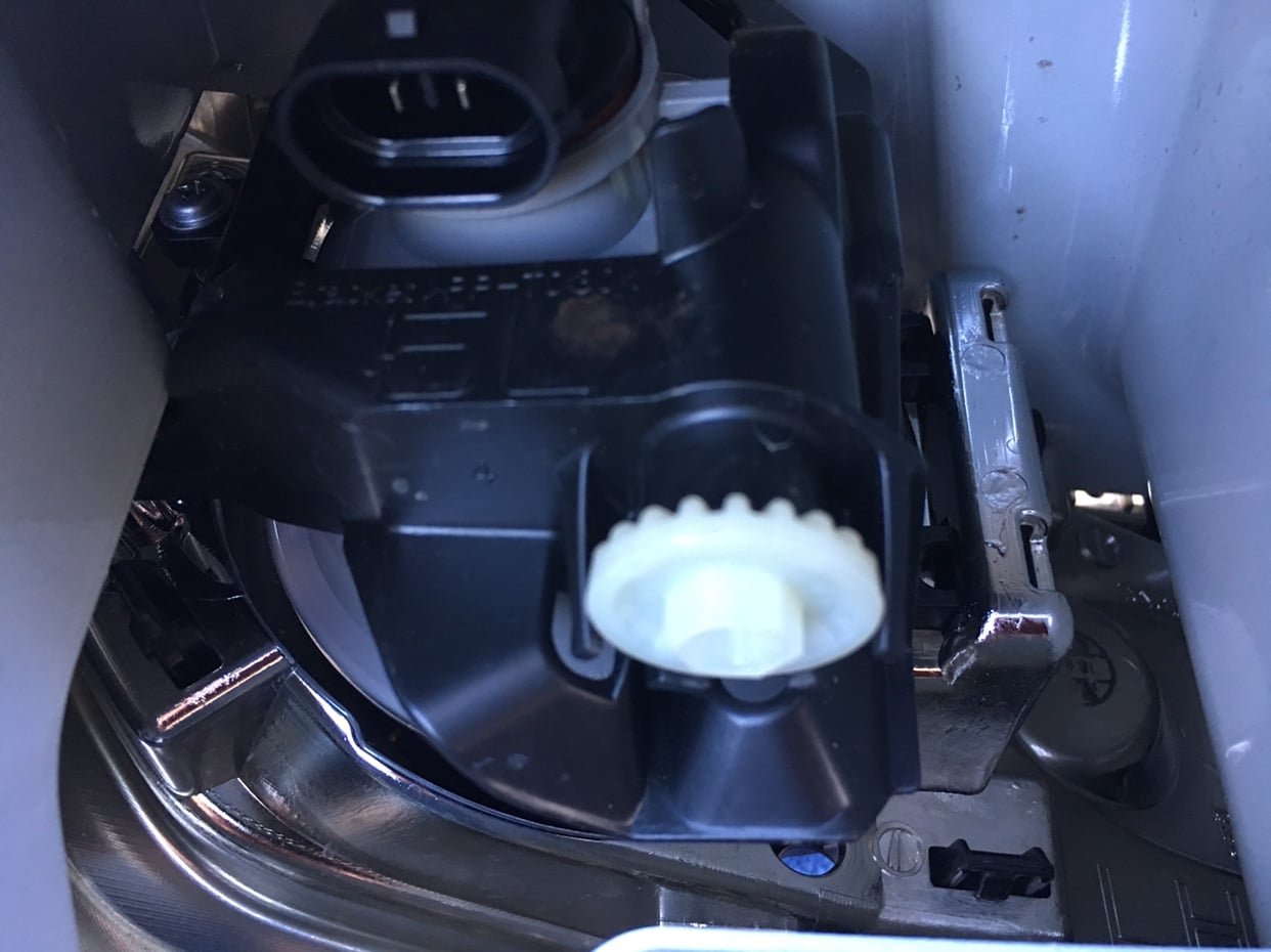

You do have to remove the chrome tabs. There’s also two inboard that have white clips. I’ll take better photos later as I reassemble.

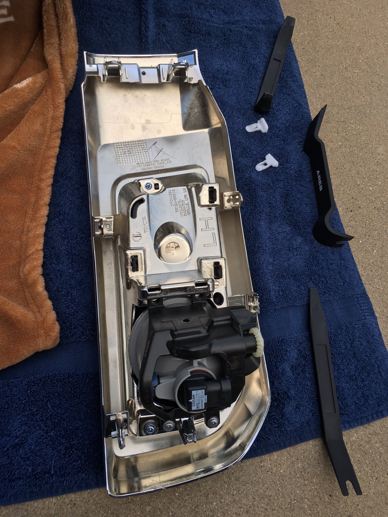

This is what you have to release on a 2019 Limited.
White tabs (red)
Chrome clips (green)
Screw (blue)
You can see why the front had to come off now. [emoji16]

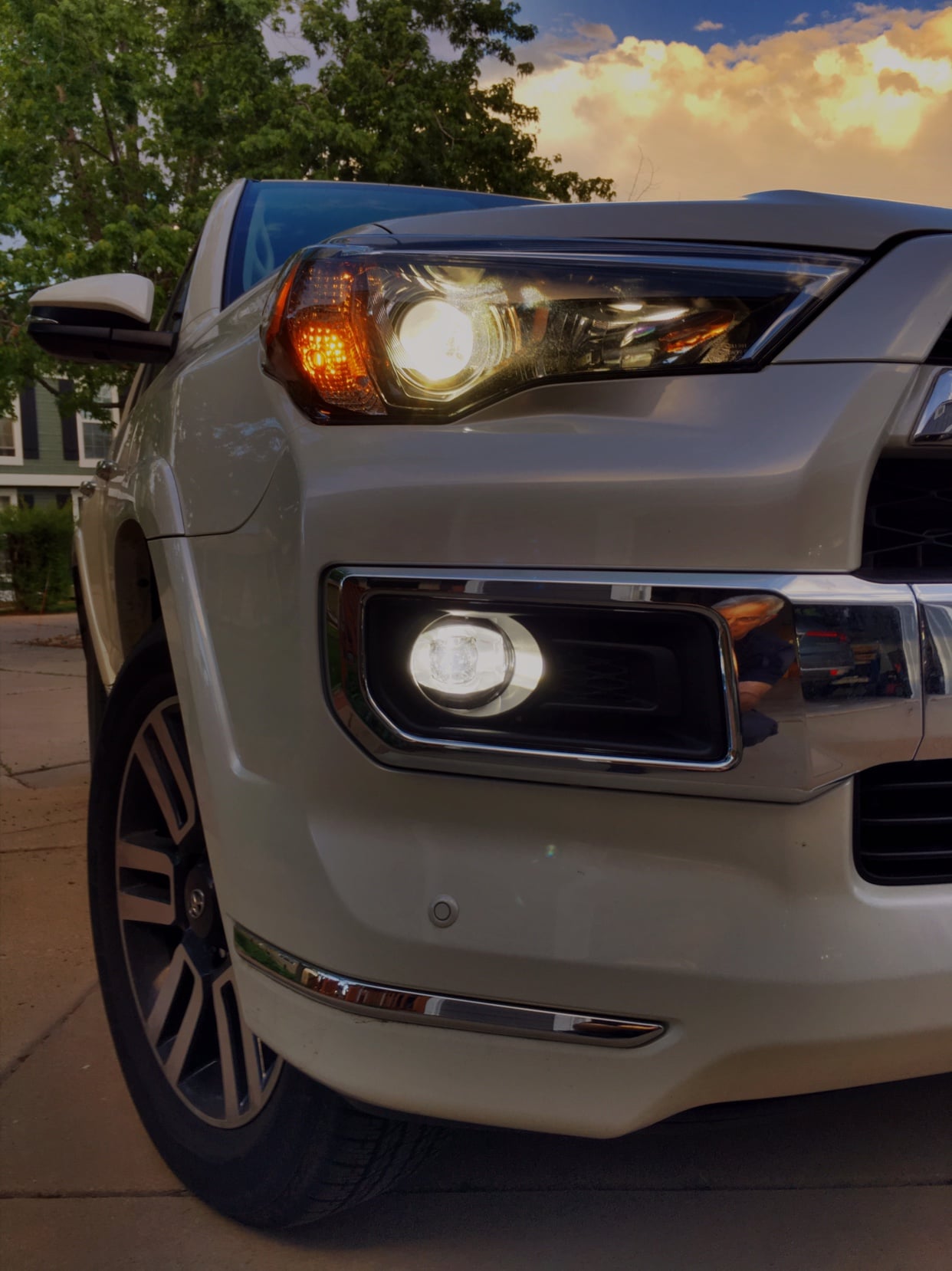

All done. OEM LED fogs against Xenon Depot 4300k Philips HIDs.
The fogs make the HIDs look very yellow in my garage. The fogs easily outshine the HIDs in the close space of my garage.
I’m a bit confused with the HIDs. Initially I loved them but lately they appear dimmer and more yellow. Im beginning to think I should have bought the Supernova V4. Oh well...
