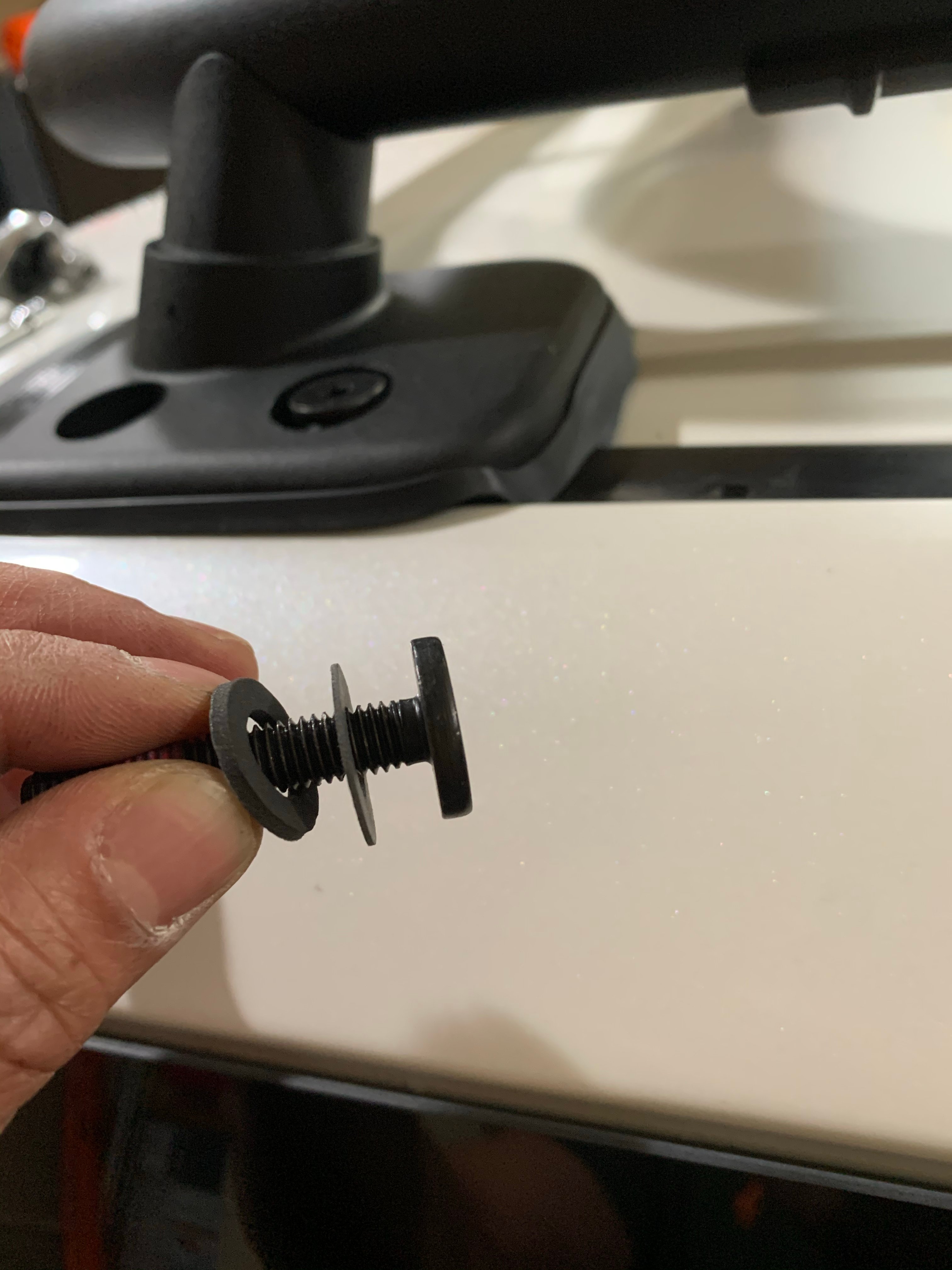

Here is the kit. I believe you have all the parts already except the two sets of washers. When you take them off your 20, the washers may fall apart and it’s better to replace with new ones.
One is foam material and other is a hard card board. I believe this will make the install water proof.

Actually the kit i posted is for the fj. Not sure if there’s a kit specific for the 4runner as of yet. But when I compared the bolts and the washers, they looked exactly the same. Only thing with the fj kit is you’ll have extra parts.
When I purchase my rack you can see the original two washers (foam and cardboard) still stuck on some of the rack holes. But some were missing so i scraped them off and applied the new ones.
