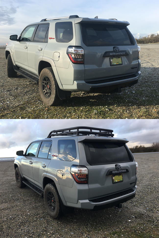

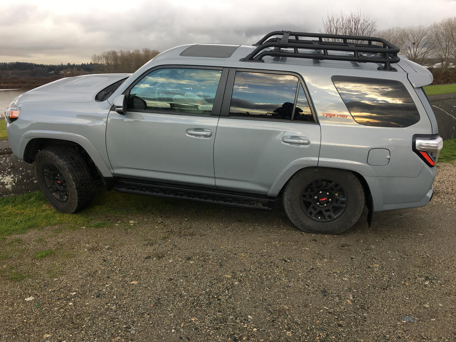

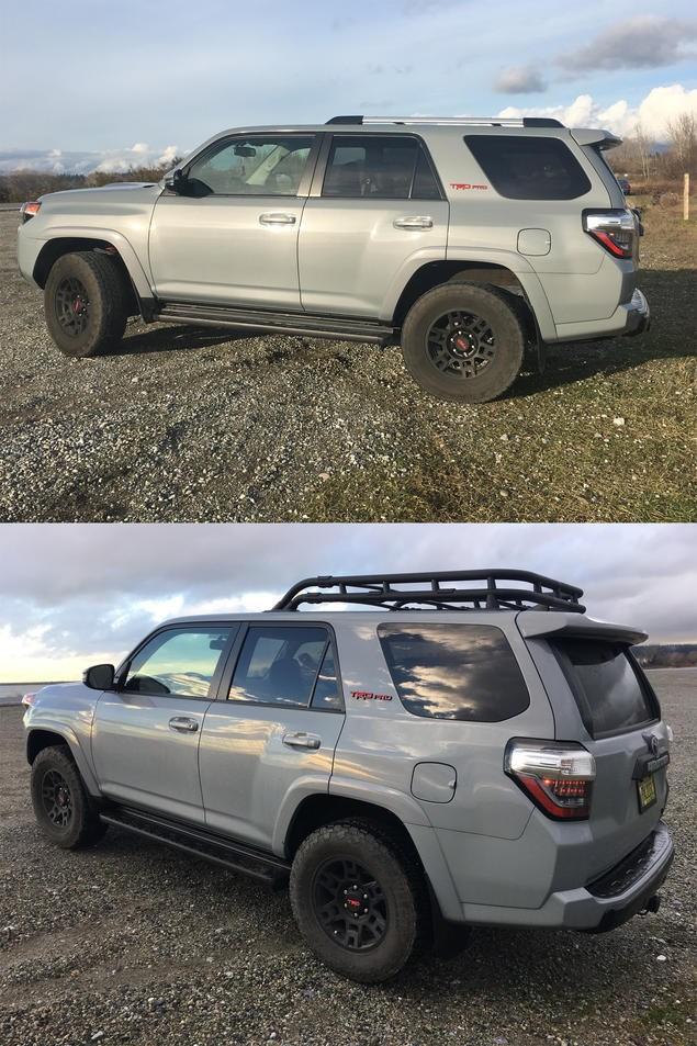

No. If you have the rack you can order a kit with the 16 washers you need + the 8 bolts for about $15 from Amazon or Toyota.
The things that cover the feet scratch the clear coat on the roof. I replaced mine with an actual rack 2 weeks ago (after I had the truck for about 18 months), and there are U-shaped scratches at each mount location.
This is awesome man! Did it take any modifications or silicon? I've heard the bolts are different, so I'm not sure if that played a factor into the install. Looks great!
