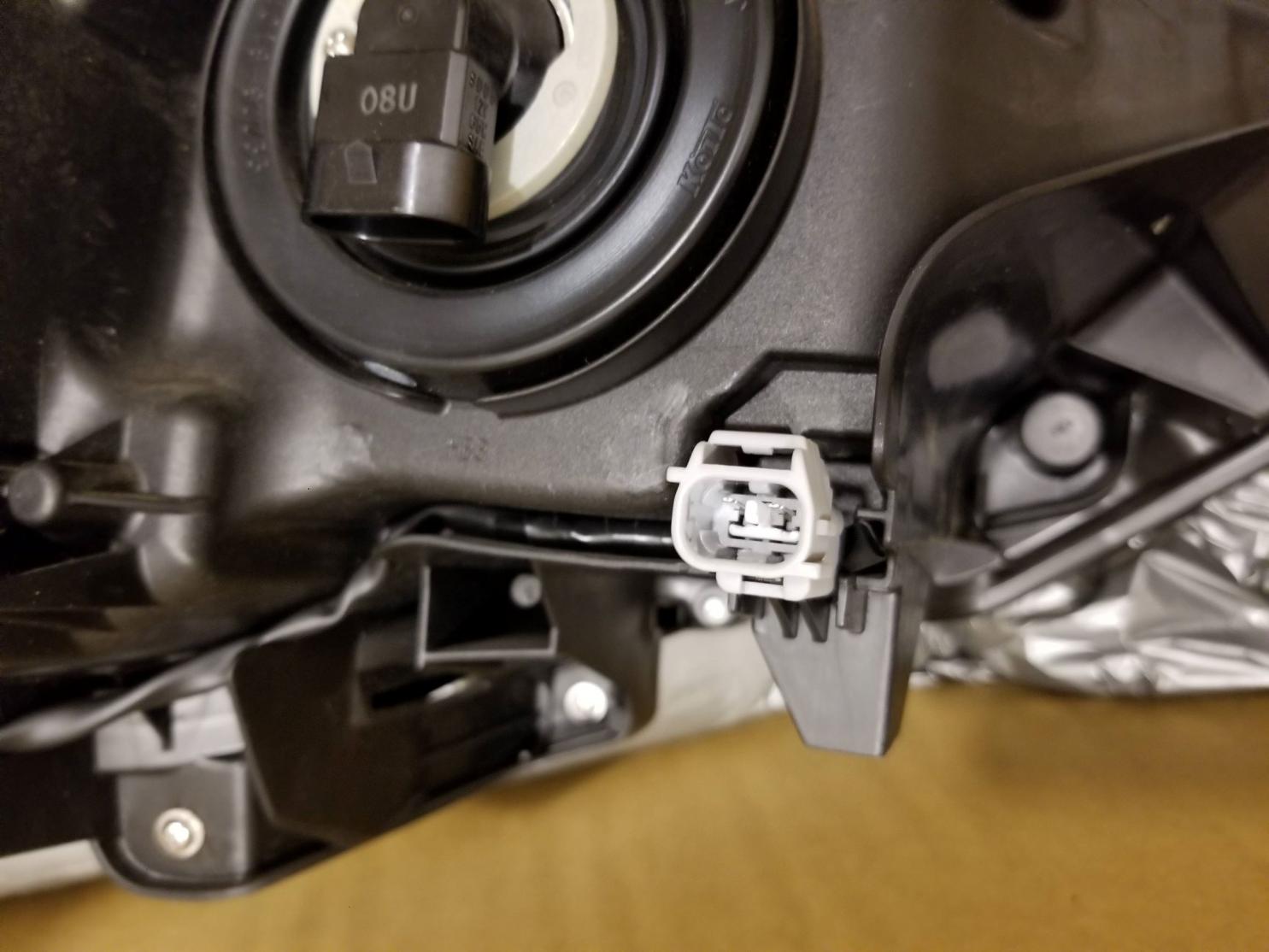

From talking to a person that has done this, for the non-Pro/Limited model (meaning just LED low-beam) it's very simple.
You remove the connector with the arrow below and replace it with a connector that matches the plug used on halogen models. Literally 2 wires and swapping a connector. Done.

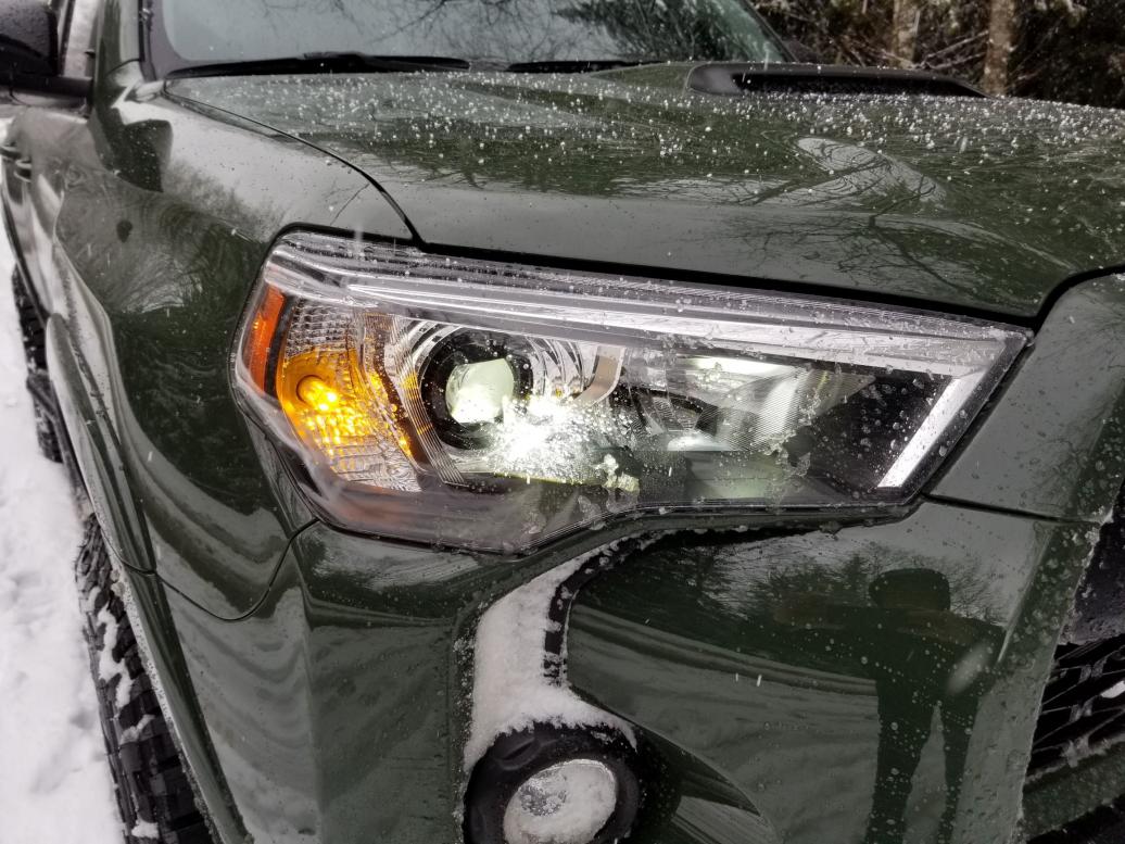

Neither the Tacoma or the 4Runner have heated LED headlamps. You also have to remember that the window for snow buildup is rather narrow- you need heavy, wet snow near the freezing temperature. If it's colder and drier, it won't stick. Slush buildup tossed up from the road can be a problem though.
This is in Moab a year ago. This is why I went back to halogens and upgraded to H9’s. Halogen headlight and LED fogs.

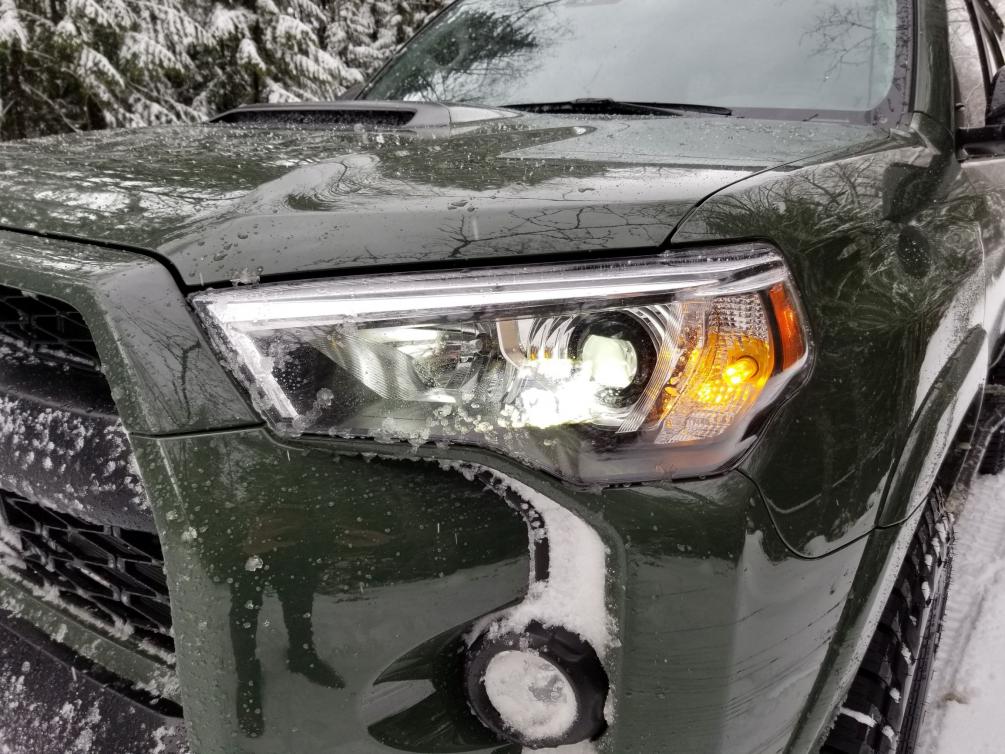

Here's a few exterior shots of the LED low beams.

So that's an H11 male connector. Is it glued in there now ?
I will also add, I live in Canada and drove through a few snowstorm already this year where some snow accumulated at the front of the car, but snow accumulation on the headlights was not an issue.
So I’m not saying that it will never happen, but in Canadian winter conditions it’s not been an issue so far for me.
I have no clue. I grabbed that picture from way earlier in this thread ... someone else put it there. :-)
You can see the conversion clearly here (also grabbed from previously in the thread). It looks friction-fit to me, but you could prob go look at your 4Runner for sure.
376396d1612403871-2021-4runner-oem-led-headlights-lights-performance-retrofit-2021-4runner-oem-led-headlight-plug-jpg

This workaround is very simple if one can determine what are the connectors. From my quick research, the pre-2021 plug is part# 90980-11255. I haven't found the 2021 plug.
So we have 2 options. Either make a short harness with corresponding female to female plugs (assuming we can find them). Or replace the 2021 plug with a part#90980-11255.
