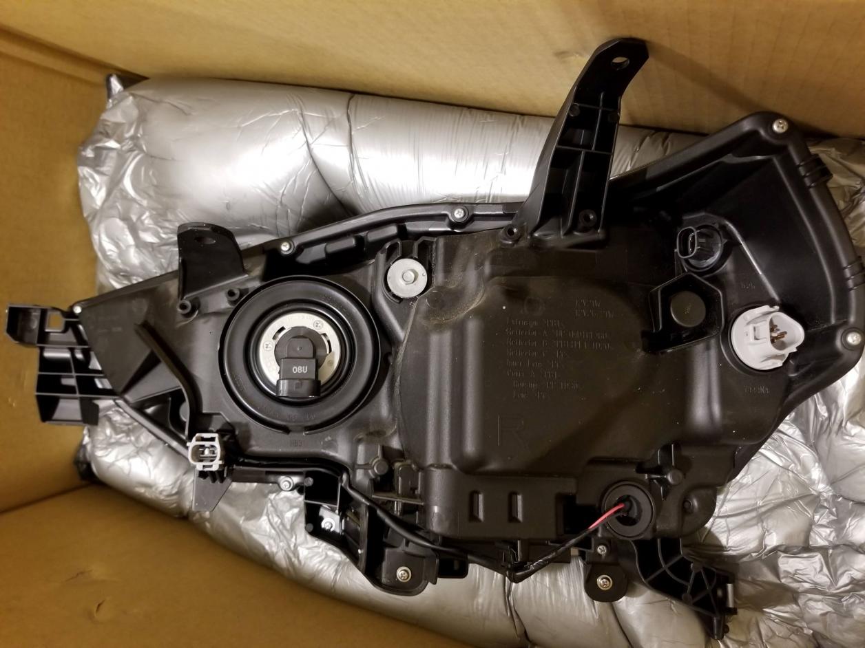

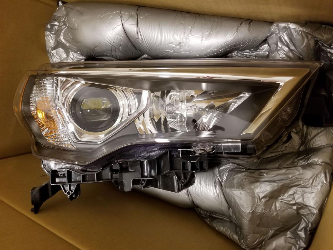

Finally got to unboxing these bad boys from Alex. Thank you so much for the quick shipping and extra protective packing. They're off of a 2021 Trail Edition, so it's the LED low beams and halogen DRL/highs. Installing them tonight. Will post some light output pics later this week vs my current set-up (35W Xenon Depot HID kit).

I look forward to seeing the comparison. I still find it comical how Toyota retrofitted an LED projector into the existing housing without any changes to the design and called it a day.

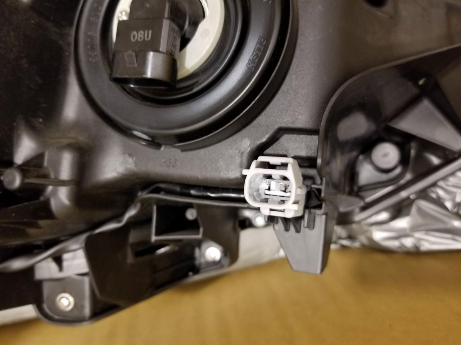

Can you see what the modification was? Is it really as simple as putting a new plug on a single set of wires? Kinda what it looks like looking at the picture.

I believe it is that simple, Alex just installs a new plug on the LED low beam wiring harness.

I think we're nearing the end of life cycle for the 5th gen. Wouldn't make sense to do an entire sheetmetal refresh for the last year or two in order to accommodate a new housing design. Would have been interesting to see them do an LED reflector like the new Tacoma. Much more efficient.
