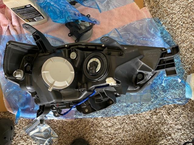

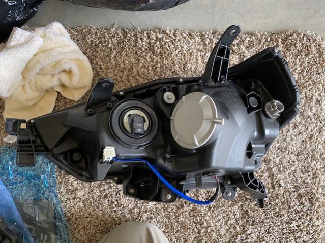

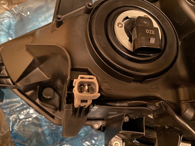

Anyone that has the 2021 headlight housing could please take a photo or tell me what is the polarity of the LED plug?
I just bought (and received) the new LED 2021 headlights. I swapped the plugs from my older headlights (my right one was wrecked), but I completely forgot about the position the red and black wires when I did the retrofit...
Is this what you need?

That's the only photo I have found.
If you want to get your hands on a pair of headlights from a 2021 4runner, then the 2 wire plug for the low beams as well, its a pretty easy plug swap and now you have the new headlights!

its either one or another...... Its not rocket science. No 2021 owner is going to be able to slit the wire looming to trace back the red/black wires all the way to the plug to let you know which side is what...
If it doesn't work, then you know you got it reversed..... lol

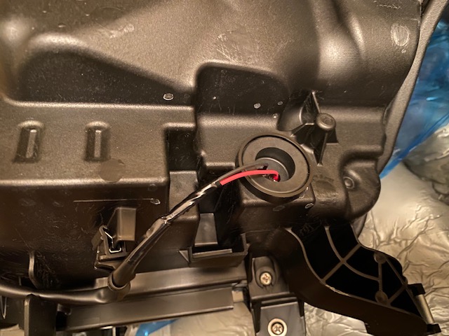

Here are my photos. As you can see the color of the wiring is hidden by the wire loom

Thx for sending the pic.
Quick answer ... I dropped the headlights by my mechanic then I realized that I didn't check the polarity after the mod.
It is tough to work on switching the cables after the headlight install and I don't want the mechanic to fiddle with the plug.
Also, the wires are visible just behind the white plug.

I don't remember being able to see the color wires behind the plug as it has a sleeve over it. Its on the car now and I am able to see. I am looking at my 2018 Headlights now bc they are off, and you are unable to see the color of the wires bc of the blue sleeve...

I do not know which side of the plug is positive and negative. On morimotos brown is positive and black is negative, on the 2021 red positive black negative.
