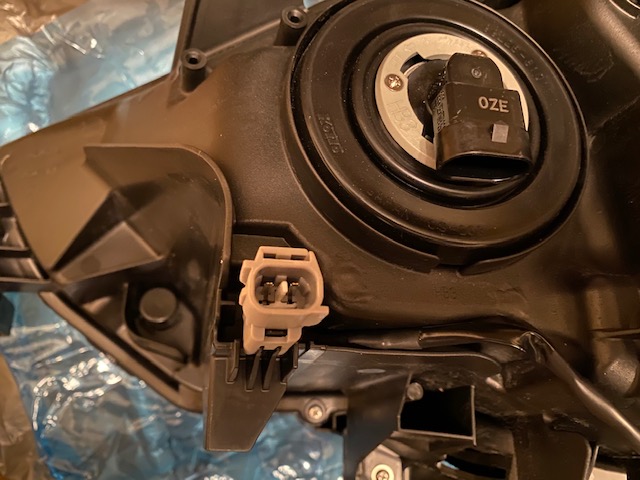

Anyone that has the 2021 headlight housing could please take a photo or tell me what is the polarity of the LED plug?
I just bought (and received) the new LED 2021 headlights. I swapped the plugs from my older headlights (my right one was wrecked), but I completely forgot about the position the red and black wires when I did the retrofit...
Red and blue are on top. I swapped mine with the oem toyota plug from the harness and it plugs directly in.

Super easy. Get some pre 2015-2020 headlights from a junkyard or etc and take the connectors off and splice them onto the 2021.

The harness your looking for only comes with the headlight itself.... only way you will get what you need will be off of another Oem headlight or aftermarket source like morimoto who is able to use their lights for the 2021 4 runners

no, you need to take the connectors off a 2016-2020 halogen headlights and put that connector onto the 2021 headlights so your factory headlight chassis harness will plug into the 2021 headlights.....
Yes, you could make some butt connectors or jerry rig it to work. I did that initially before to see if the 2021 led headlights would even light up on a pre 2021 4 runner..... I returned those 2021 headlights and decided to purchase some already harness converted 2021 headlights for a lower cost......
