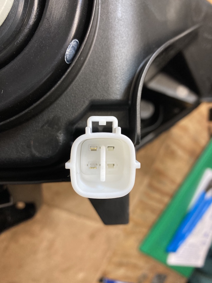

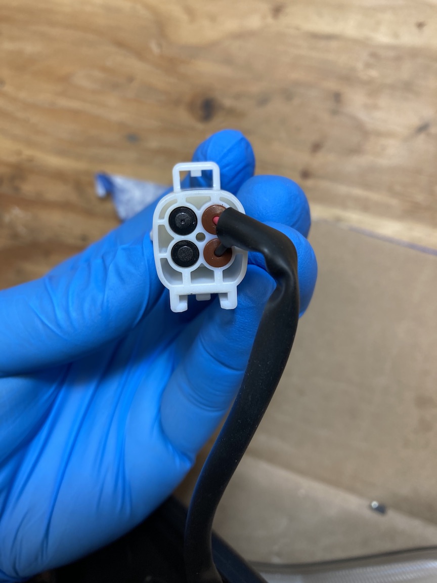

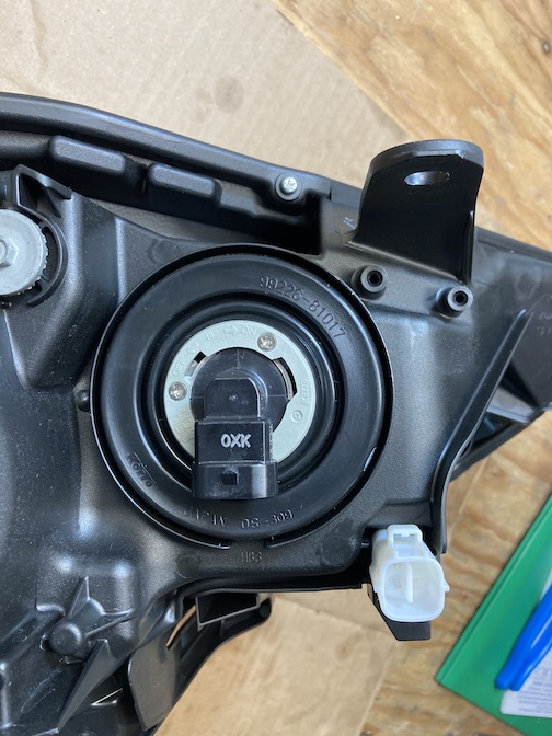

I have a 2021 SR5 premium and the low beam harness is different from previous models. I tried to install some alpharex lights and noticed that they don't fit. I called alpharex and they said that they are developing a new harness/adapter. So hopefully I'll be able to install them soon.
The swap to AlphaRex on a 2021 model has been done. A member on another forum that I have spoken to did it in December without a harness. He has some electrical knowledge but has said it’s doable with minimal modification.

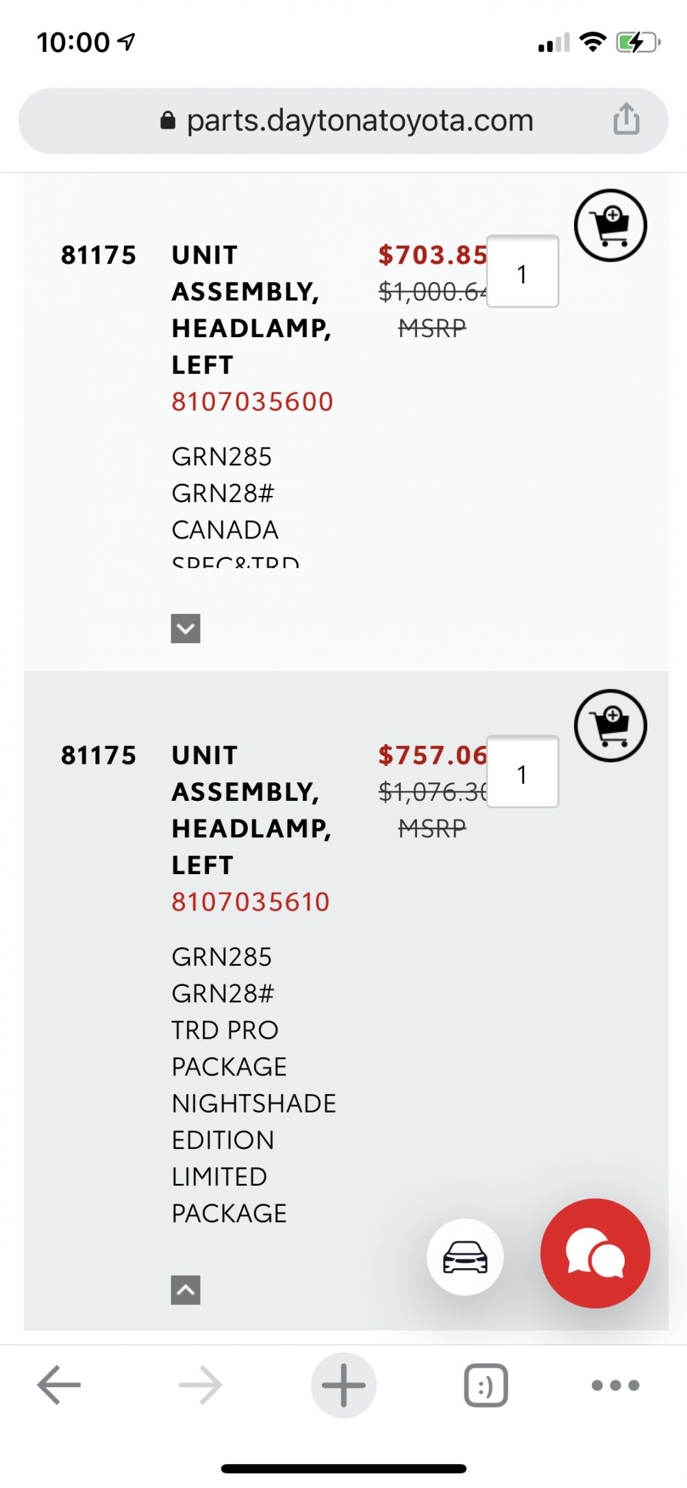

I am about to order the 2021 led headlights
There are two versions. Can anybody clarify?
There is a small price difference. I am assuming one is Canadian version? What’s the difference between the two?
It looks like the mounting points are all the same.
I will update you guys when I start doing the install with photos and etc
