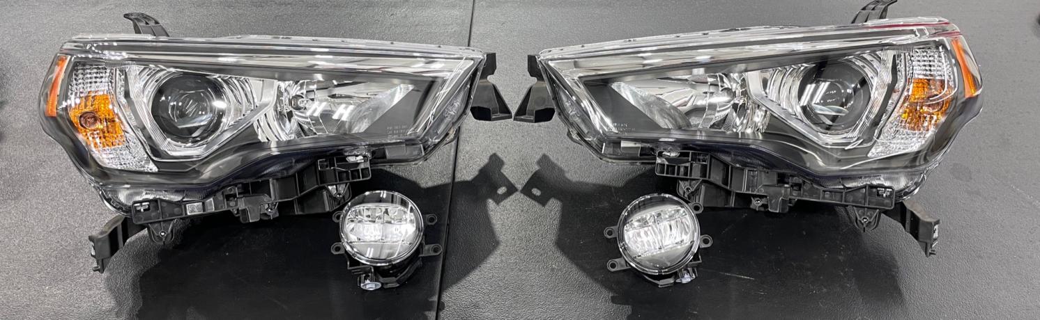

Hey guys, my name is Alex and I do Morimoto conversions to a bunch of vehicles, one of them is the new 2021 4Runners. I have a couple sets of the new LED headlights with matching LED fogs that have less than 100 miles on them and it sounds like some of you might be interested in purchasing them. Since I'm a new member, I cannot post in the classifieds yet. If any of you are interested, send me a private message with your phone number and I'll get in contact with you. This set I'm showing is off a Trail Edition so it has low beam LED and high beam halogen. The only modification necessary was to transfer the low beam connection from the Morimoto to the Toyota, that has been completed already. I would suspect that these should be plug and play now since the morimoto's just plug in to the 4Runners. We have installed a set into a 2017 halogen equipped model without any problems, but your vehicle may vary.
We are charging $1000 shipped for a complete set of headlights and foglights.

We did already install a set into a 2017 halogen model and it worked great! I didn't know if I could post pricing with this not being a classified add, but we are charging $1000 shipped for a set of headlights and foglights.

That is correct, these plug right into the existing vehicle's harness
