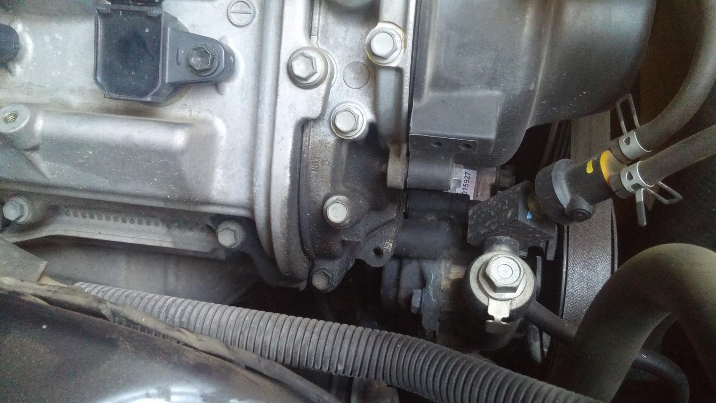

About 4.5hrs of labour + parts to replace the water pump, timing belt, and drive belt on a 2UZ-FE (+.5hrs to replace the Cam and Crank Seals on the Non-VVTi variant in the rare case one or more may be leaking). If the vehicle is over 150k I usually recommend also replacing the thermostat and radiator cap while doing the work, mainly because by about 100k the radiator caps seem to start seeping pressure and while I haven't seen too many thermostats fail on Toyotas, it has likely been in the vehicle a while and while I have it off anyways it's cheap insurance for the customer and I.
If you have a 2UZ-FE with VVTi and the Cam Seals are leaking (look at the valve cover where it clamps over the front camshaft bearing cap, it'll look like the cover is leaking from the corner where it meets the engine, but it's actually seeping from the seals behind the metal timing belt shield and running down the front of the engine. It looks something like this to varying degrees of wetness/griminess:
214354d1470409250-cam-crank-seals-4-7-vvt-i-0702161957a-jpg
This is Toyota's brilliant way of designing the cam seals for the VVTi variant of the 2UZ-FE:
To fix that, the camshafts have to come out of the vehicle and need to be disassembled to get access to the seals to replace them. That will be about 10hrs labour (depending on how bad the leak is an additional .5~1.0hrs of cleaning time and 4-6 cans of brake clean may be added to the quote), includes timing belt, drive belt, and water pump replacement, valve cover gasket replacement, and cleaning of the residual oil mess (in this case if the vehicle is over 150k I'll recommend a radiator cap, thermostat, and PCV valve replacement while doing the work).

I apologize for such a late response, but your response was most helpful! I am getting this done this week for $1100 and the shop is using an Aisin kit. Thank you for the help!
