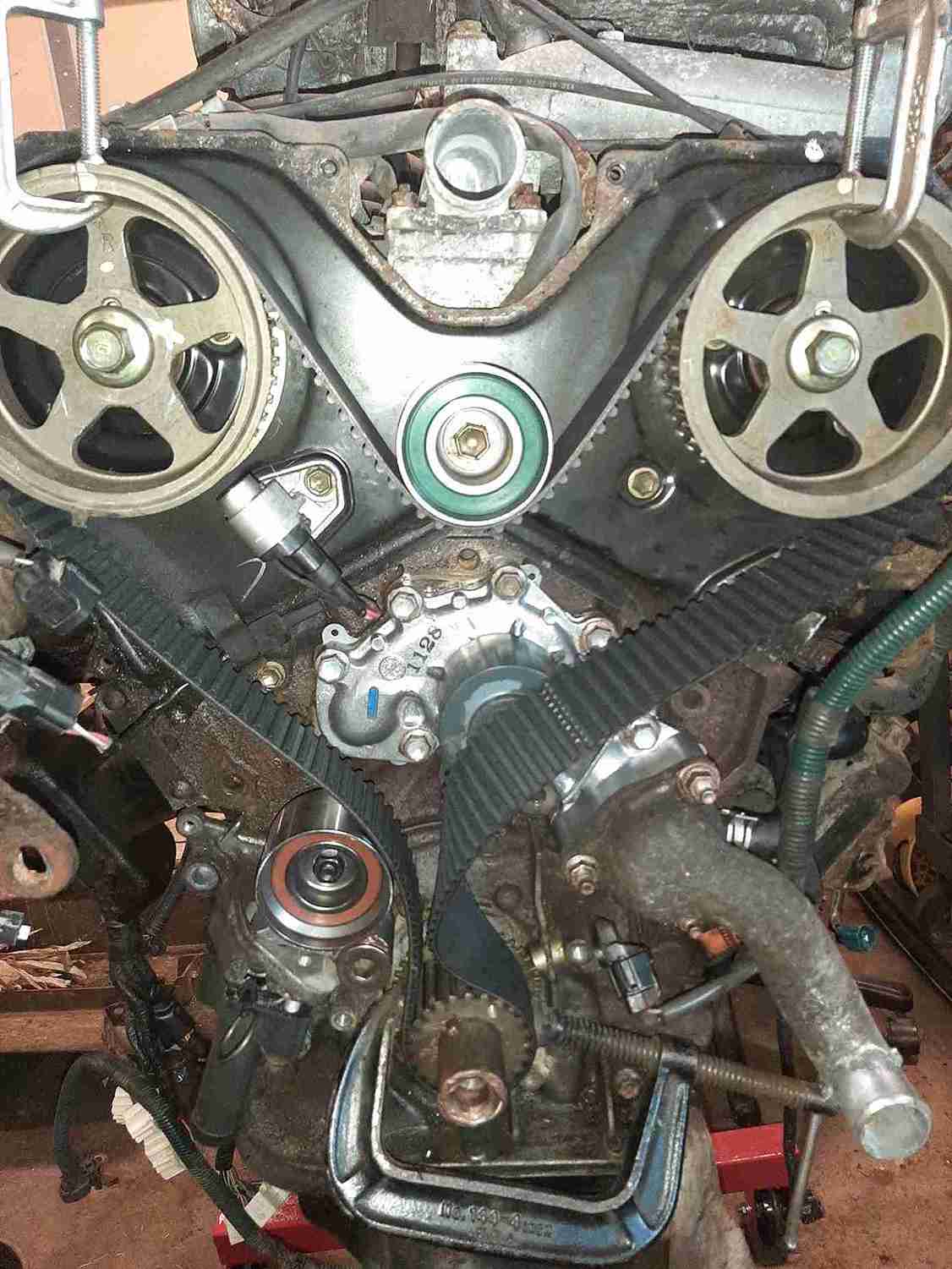

This is a photo of the last 5VZ-FE I did. Granted its on an engine stand. But you can see how I do it with C claps. I have all the play at the water pump so its a lot easier to put on this way.. Small C Clamps work great in the vehicle. Maybe it will help you maybe it wont. But with the c clamps locking the belt... It cant jump doing it this way...;-)

[MENTION=164664]brillo_76[/MENTION] yes c clamps work fantastic, just don't clamp them to hard.
But you can see how I do it with C claps. I have all the play at the water pump so its a lot easier to put on this way..It cant jump doing it this way...;-)
Clamping the crank is a brilliant solution. Thanks for posting and cheers to 2TH4IST for continued support. Will update for sure.

Exactly.. Just used to hold the belt in place... That is the best way I found to do this. Can put a belt on in like less then 5 minutes this way. Also those really big black paper clips work on the cams as well. You do need to use common sense doing this. Just tight enough to lock the belt to the pulley.
I also use a metal bicycle tire iron. Once that belt starts on the water pump pulley you got it made..:D It will go. Its so much easier this way because the water pump is smooth so the belts slides onto that pulley with ease.. The sliding on the crankshaft can be done... Its just easier and faster this way I have found.. :-) I did one that way and it had to mess with it a while. :)

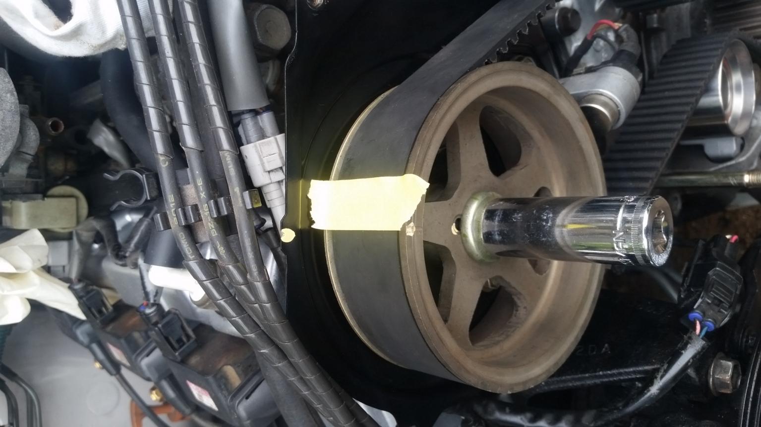

To recap I used an OEM belt and crank belt mark was never going to reach the crank pulley dimple no matter how hard I pulled down. The consensus is just to ignore this mark and proceed. Why would Toyota have the belt mark in the wrong place? Maybe some aftermarket one yes. Hasn’t Toyota calculated the distance between LH cam and crank and positioned the marks exactly for initial installation, like they have for LH and RH cam marks. Why was my belt not reaching it’s mark/correct crank tooth for tension on driver side. Is the problem the rubber water pulley diameter or it’s position is off centre? I can’t fathom out why what should be a simple procedure have so many installation variables and techniques, like slacken this, remove that, turn it slightly this way etc. Did the Toyota engineers get it wrong? Are some people just lucky when installing?
Anyway as my cam marks are off I will pull it off and try again if [MENTION=164664]brillo_76[/MENTION] has any further guidance it would be appreciated. I’m really pissy sick of this.

All went well until fitting the timing belt. Everything at 12, Toyota belt marks (arrows pointing to front and held with binder clips) aligned with cams. CR belt mark wouldn’t reach, 1 tooth short on the pulley with a some slack between. No matter how hard I kept it tight I couldn’t get the mark to reach the pulley indentation, so tried doing it first, same result on RH cam – 1 tooth short. Ignored the CR mark. The cams were at 12 but the CR would be off by a tooth or the CR aligned and the cams didn’t or all would be off. I spent two days fighting this. Slackening or removing top idler only pulled the alignment out. Same for tensioner. I eventually got it on by rotating cams and CR to compensate for them moving when prying belt over bottom pulley whilst simultaneously holding RH cam with wrench to try and stop it moving, but it was so tight all round pulling the pin made no difference. The cam marks were still slightly off.
