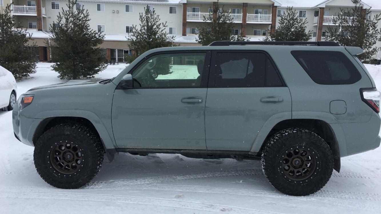

I'm running scs wheels with 275 falkens with stock suspension and on my 21 pro they rub a lot but on my 20 pro they didn't rub but in my opinion they look so much better then the stock wheels
What size are you running? 17*9?
