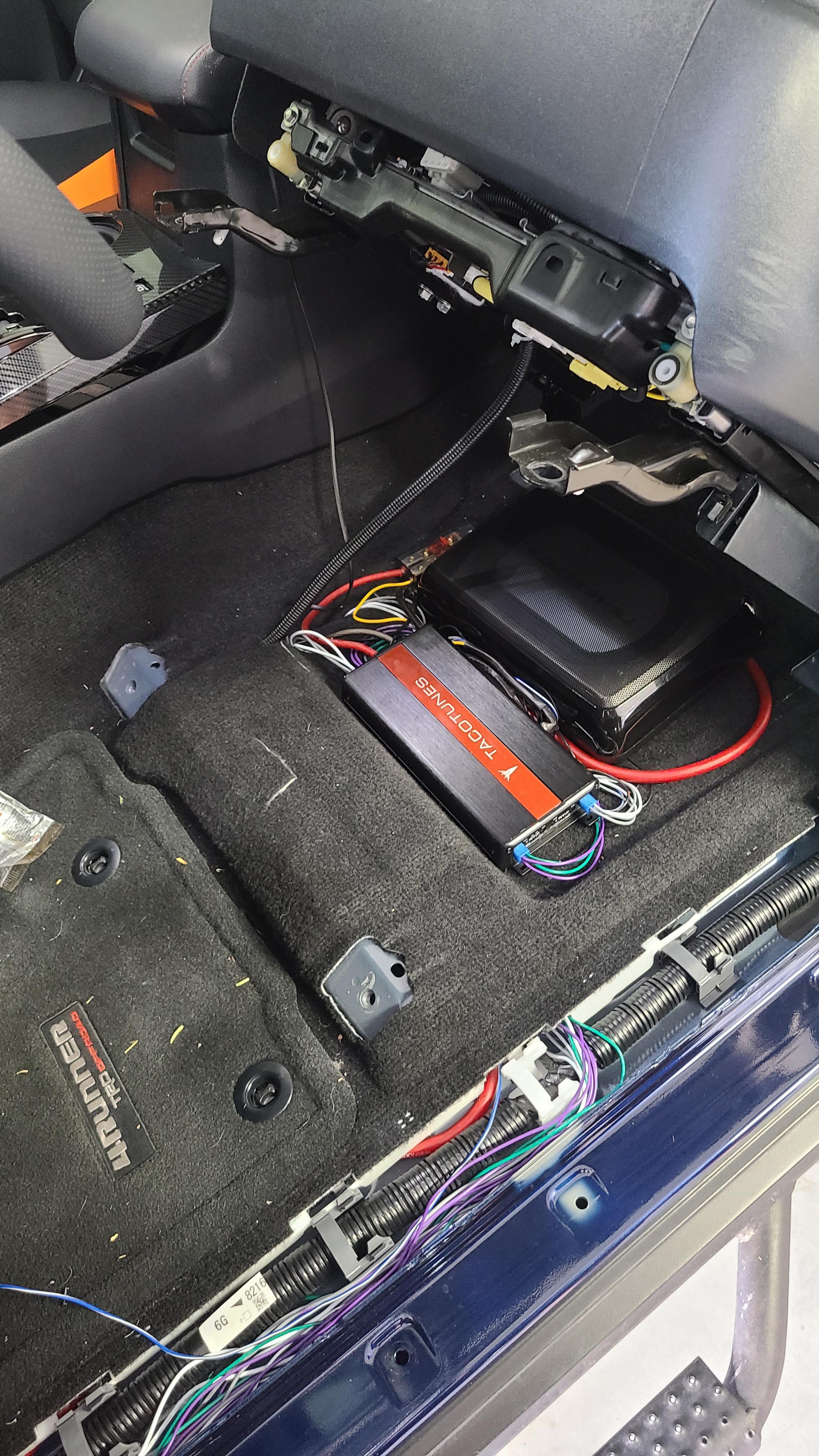

Got it all installed. Works and sounds AWESOME!
Pricey but quality. I appreciate their YouTube playlist showing the install and their customer service. I ordered an 8 Guage amp install kit but they sent me a 4, which is better and twice the price, so I cant complain. Their website sucks, and shipping was ridiculously slow (Covid to blame) but overall really good experience with these guys.
Thanks everyone for coming in with advice. Really appreciate it!
is that an under the seat amp next to the TT amp?
