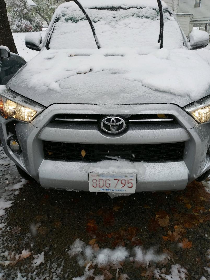

mine does it alot in the winter. If snow is blowing in front of the radar panel in the grille....it gets confused and shuts off temporarily.
