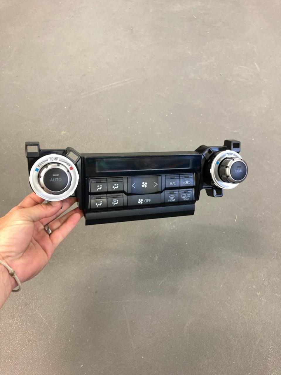

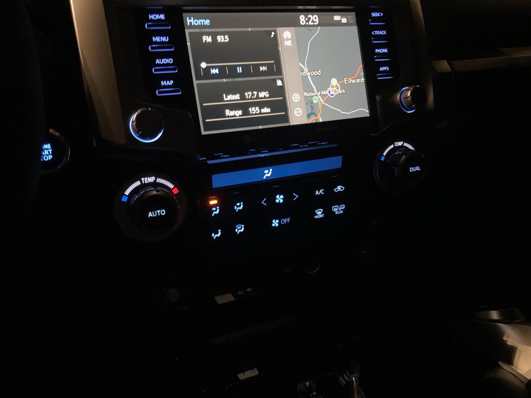

Two things in regards to US and Canadian specs... Im not sure if people are aware of this but in Canada we get premium specs by default... In canada the non "premium sr5/ off road" isnt available, unlike the US. specs. Also when it comes to climate controls i noticed the CDN specs are different than the US specs.
The U.S. versions tend to have the triple knobs, whereas in canada we have two knobs and buttons to control the directional airflows. I believe that the 2 knob button w/ directional airflow buttons are only available on US LIMITED editions. Don't quote me on that... I bring this up because they might be using the same concept for wiring of the headlights for Canada / us specs...? :-/

That is what i'm referring to. from what ive seen the premium offroad in the us does not offer that climate control, offered only in the limited edition. But in canada all the TRDOR comes with that "limited edition" both my 2020, and 2024s had that. I'm just bringing this up just referring to above where it was mentioned that canadian and us versions versions might not have differences with wiring/ options...etc

Two things in regards to US and Canadian specs... Im not sure if people are aware of this but in Canada we get premium specs by default... Also when it comes to climate controls i noticed the CDN specs are different than the US specs.
this is correct, you have the climate control system like the
limited in Canada.
