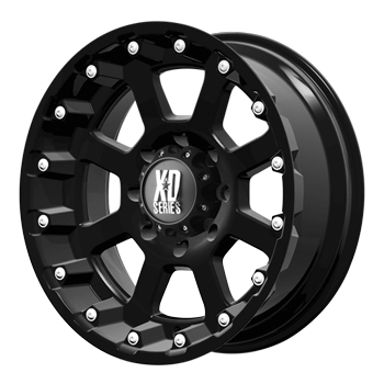

Hello new community! I've been lurking these boards for the past 6 months and finally just got a 13 SR5 yesterday.
I'm ready for my first mod, wheels. From what I've been searching it looks like a 20x9 -12 offset with 4.5 backspace is the perfect size for me. Looks like just a hint past the fender.
My #1 choice for a wheel is the KMC XD Strike, but only comes in 20x9 +18 and 5" bs. . .based on calculations almost 1.5" more inside
The only other option they have is 20x10 -24 and 4.5 bs
Calculations say .03" more inside and 1" more out (not to mention a much wider lip which is a plus)
I was wondering if anyone was running 20x10 similar to this setup with no lift, and if they have rubbing issues.
Heres a couple pics of the strikes:
The further out your wheels stick the better the chance of rub. Good luck. Read the Tire Fitment Guide in my signature.
Im new and have been doing a ton of looking for that exact set up. I will be running a 20x10 -24 offset on 35's. I expect to do a ton of trimming and body mount chop and maybe run a 1" body lift (In addition to Icon Stage 2)
I found a member on here that is running 20x10 welds with no lift and no rub. You can look up Roadrash5x and see his set up (Looks nice and wide)

Curious, did you get a 20x10 to work? If so, What was the offset? Any rub? I also found the other member mentioned in this thread who was running 20x10 but didn’t find any mention of the offset.
