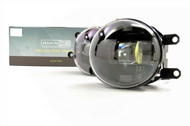

I raise you a Morimoto! Toyota (Oval): Morimoto XB LED Projector Fog Lights LF220
I'm glad I asked before ording anything....I knew the headlight bulb was not replaceable I didn't know the fog light bulb was also not serviceable.
You might want to read that thread I posted the link to first. The Morimotos didn't do very well. I used to have them, so I can personally attest to the results.
I would buy literal no name junk to get that beam pattern / cutoff of the Morimotos.
