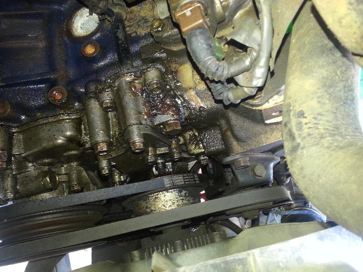

Ok so I have a new to me 95 4runner, 22re and it leaks like a siv when I am driving it, if it's just sitting overnight not a drop, if it's just idling doesn't leak a drop, but when I get back from a drive there is oil everywhere. I took the timing cover off because near. As I could tell it was coming from the top of the timing cover in between the head and cover so replaced t. Cover gaskets went back on with black oil resistant silicone, replaced oil pump o ring, main seal, oil pan gasket, oil sump gasket. Made sure every bolt was present and torqued, did not replace the dist o ring but it is dry under the dist. It is still pooling oil on top of the water pump, maybe that is from the pulleys flinging oil onto everything, it is definitely coming from the front somewhere, I am about to throw in the towel and take it to someone who knows what the hell is going on with these motors, but any insight into this cluster#@;" would be greatly appreciated, the truck runs great and stays plenty cool just leaks oil like crazy:boom:

The little bolt under the distributor gear gets too much torque and the cover will crack. This what you have. Two options, buy a new one. (there are 2 different sizes, I believe your's is the bigger one) or have Joe Smuckatelly Tig it back together. No amount of tube goo will help. The aluminum expands and contracts too much for it.
Cracked timing cover over a year.
