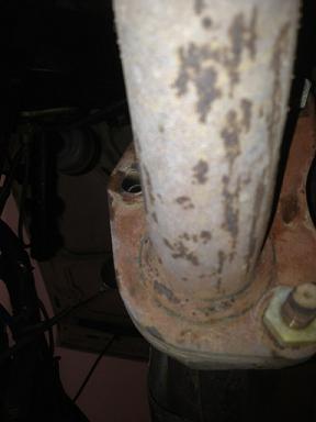

Here is the picture of where the exhaust pipe meets the exhaust manifold. Anyone know what if anything is supposed to go in there and what size? Please and thank you!

Its a stud... I think M10x1.5 if I remember correctly. I bought them from NAPA. They can look them up for you. or just use a bolt if you want.
Thanks guys. I just saved a ton of money :banana:
Bought a replacement exhaust manifold because I thought it was leaking.
as I started taking it off I found that it was missing a stud where it connected to the exhaust.
Returned the whole kit for a manifold bolt and stud kit $6.99 at autozone. All in all a pretty good day. (1.25 was the correct pitch for the stud)
Thanks I had to unbolt mine to get the truck home awhile ago and the studs were wishing when I went to put it back just wondering dose any body know the exhaust diamiter I am geting one of the flexpipe pach kits and need to make sure I get the right one
they seem to fall out and thats a fairly common issue. The problem i had once i realized i was missing one too was i replaced mine with a bolt and never was able to get it sealed up. Just trying to get by i can get a break from work and finally put my header on.
