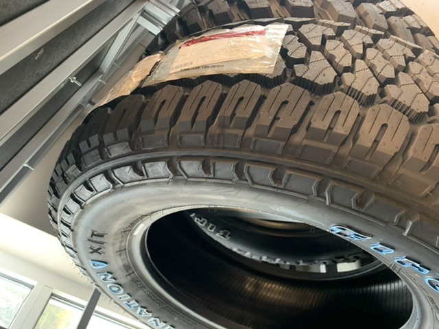

Pulled the trigger on Firestone destination X/T’s in 235-85-16. If the factory specs are accurate, they should be a whopping 14lbs per corner lighter than my current BFG AT 265-75’s.
My BFG’s are not worn out but are over 10 years old so I can’t pass safety inspection. The tread is still surprisingly good.
Firestones aren’t as tough looking as the BFG’s but they are still and e rated tire

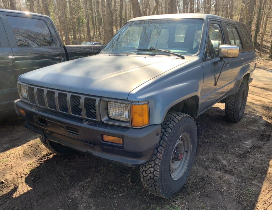

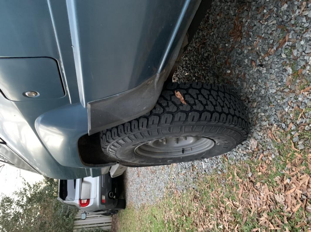

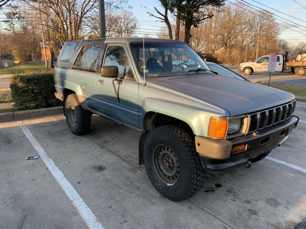

Here are some not so great photos of the dirty truck with the new tires. I miss the more aggressive looking sidewalk of my BFG’s but the firestones don’t look too bad.

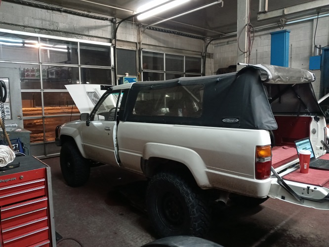

285/75x16's on both of my 4runners. Rear 1.5" spacers to remedy the spring sag in both truck, along with 1" crank on the torsion bars and Bilstein shocks. No rubbing or scrubbing on either truck, although I can't use the mud flaps with the first gen, as the bolts Toyota used interfered. It is close, but with the ifs it works.
The first gen has Kenda mud terrains, the same company that makes my mountain bike tires. They aren't as noisy as the BFG's and have worn like iron. I even cut the crap out of the tread on two of them on rocks/trail debris/whatever and haven't had a problem. My green '92 has Toyo Open Country CT's. Super tires, highly recommend them. Both tire choices are E load rated on new 16" stock Toyota 18-hole steel wheels.

Sorry to jump off my own topic a bit but what's going on with your rear bumper? Looks clean but not factory.

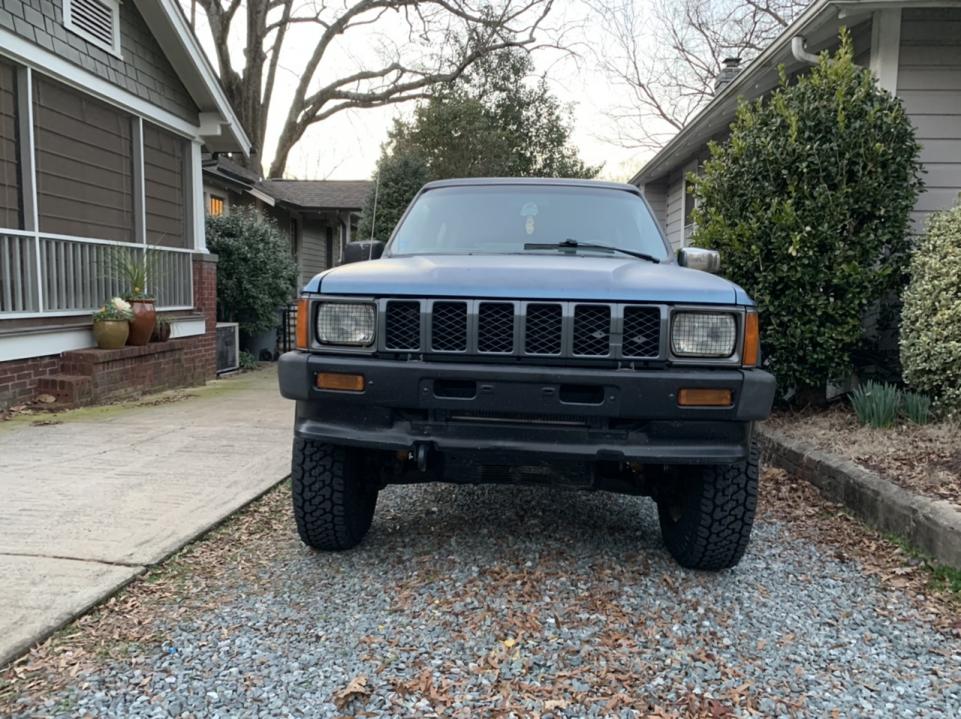

Slightly better photos.
Here are some photos with better lighting. Still weighing my options with these. I love the size and even with the heavy hard top back on, the truck feels noticeably quicker with the lighter tires.
Though it used to be, this truck isn’t my daily. However, I still have to make trips to the mountains in it which are 2 hours on the highway. I’m considering switching for a more aggressive looking tire. Problem is pretty much all other tires in this side add a lot of weight to the firestones.
Gonna take a few more days to think it over.

One of the missing/incomplete items on the old girl. Not sure whether to save up for a custom bumper/carrier or order one of the $400 Trail Gear pre-runner rear set up.....and sorry for jacking your thread with my incorrect tire size.

Those actually look really good on that truck! I prefer the narrower tread and may even go 255/85x16 when the 285's wear out. What color are your 16" steelies? I have the 18 holes as well and that grayish color on yours looks really cool.

Thanks! They are just plasti dipped grey to match the grey softopper it never really runs. Was planning on getting them powder coated but the dip has held up so well I haven’t bothered yet.

The shadow under the bumper made it look like there was a really clean custom bumper under there.
