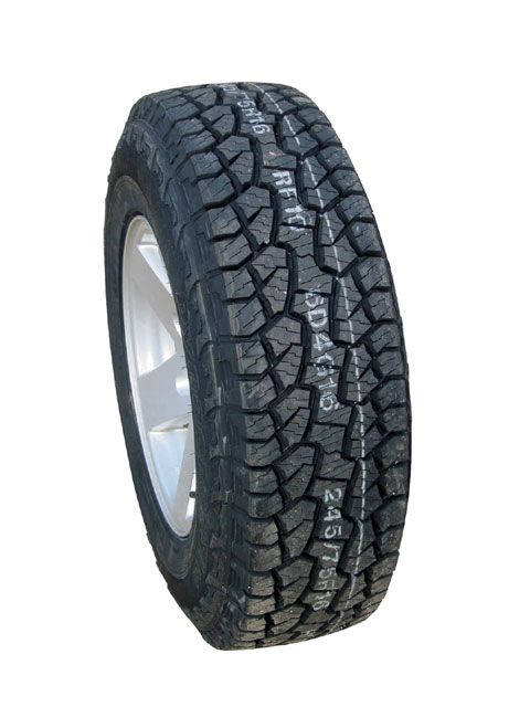

I've heard good things about the revos. I was going to try the new Hankook RF AT 10. I can get them at cost. 50k milage too. I love the look of all the big lugged MT tires just cant justify them on my vehicle.....Man I must be getting old haha

I bookmarked these a while ago as I was contemplating what size tire I would use, I looked hard at that Hankook too, that's a nice tire IMHO. It looks like a great iteration of the well-liked Terra-Grappler. IIRC the siping is cut all the way too.
