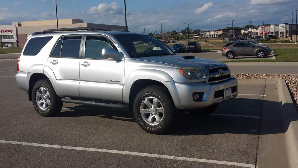

Has anyone managed to squeeze a 265/70 17 under a non-lifted 4th gen? I plan to lift it, but I need tires before that can happen.
I have them and they fit pretty mint. Mine are on +15 FJ trail edition wheels, so slightly more offset than the stock +30. I stretched the fender liner, but it wasn't really needed. They only rubbed when full lock turning off angle or slowing quickly and turning for a uturn. But nothing I would really worry about.
I've got some pictures showing fitment:
before and after fender liner stretch
i have 265/70/17 on stock sport rims without a lift & they dont rub at all anywhere. a lot depends on the tire too, wildpeaks & BFG KO etc have very aggressive tread that sticks out further than other A/T tires, a true highway tire shouldnt have any issues. also depends on how far the front is sagging but in general that size tire should fit without any issues on most stock 4runners.
