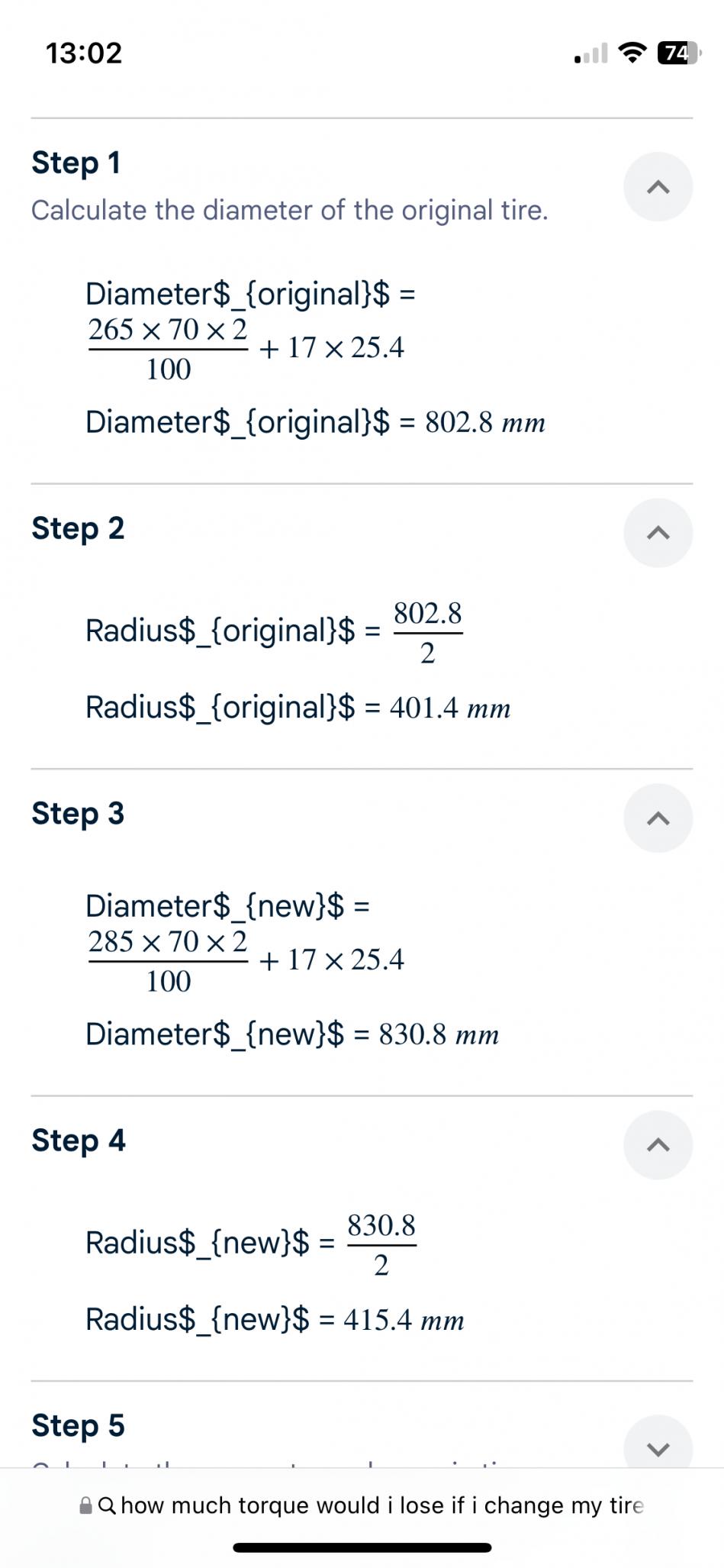

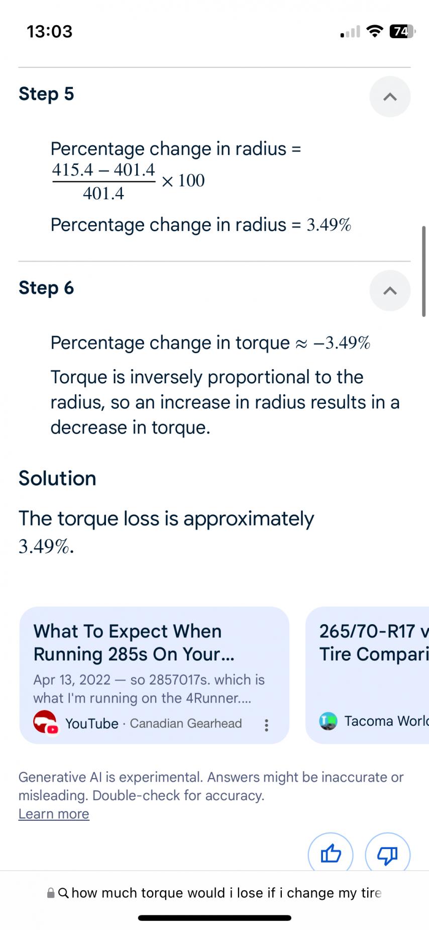

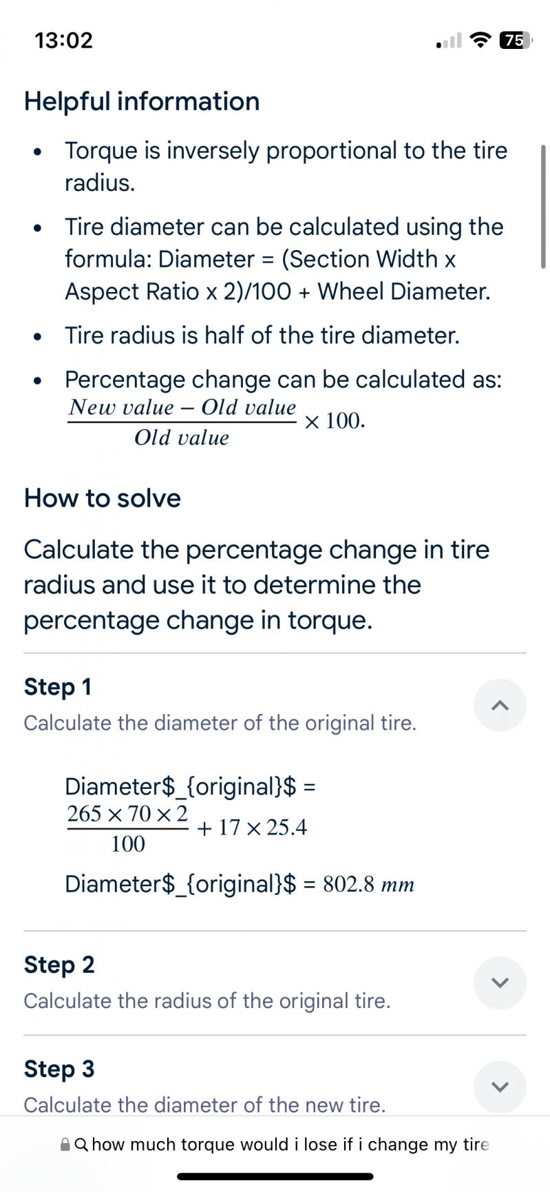

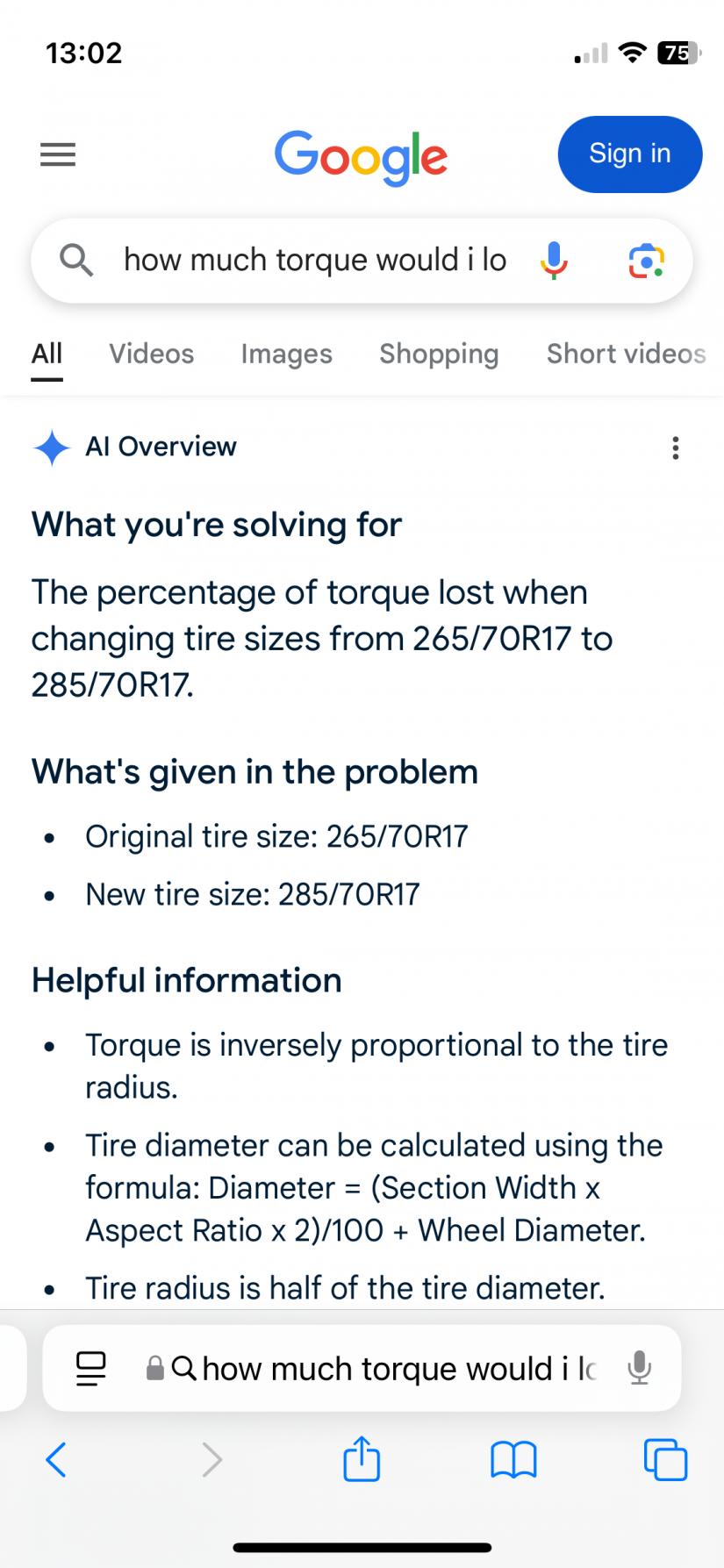

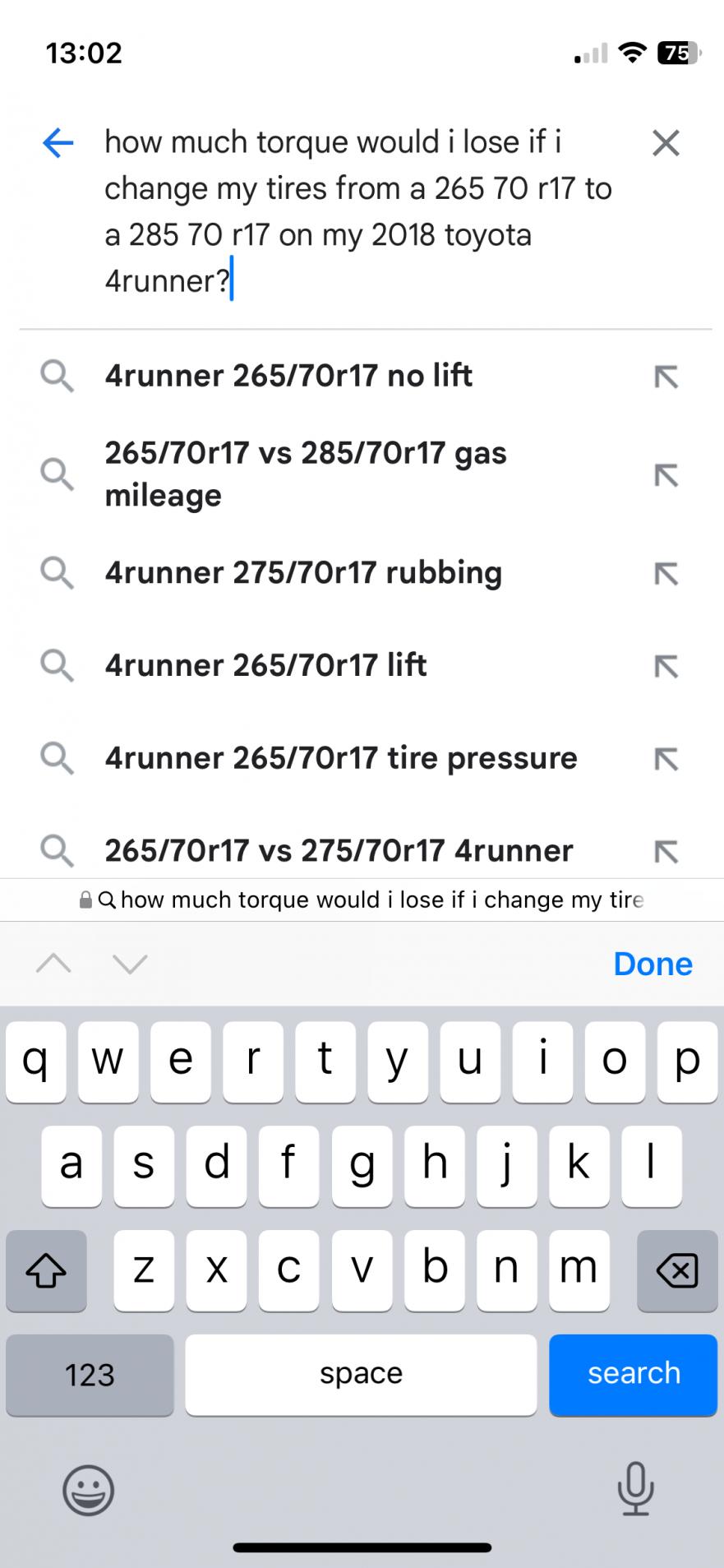

After posting this question to google/AI, I got this response:
“how much torque would i lose if i change my tires from a 265 70 r17 to a 285 70 r17 on my 2018 toyota 4runner?“
Answer: loss of 3.5% torque.

That only accounts for the radius difference and resulting wheel torque/effective gear ratio.
It Does not account for losses due to vehicle mass, rolling hoop inertia, and rolling resistance changes.
