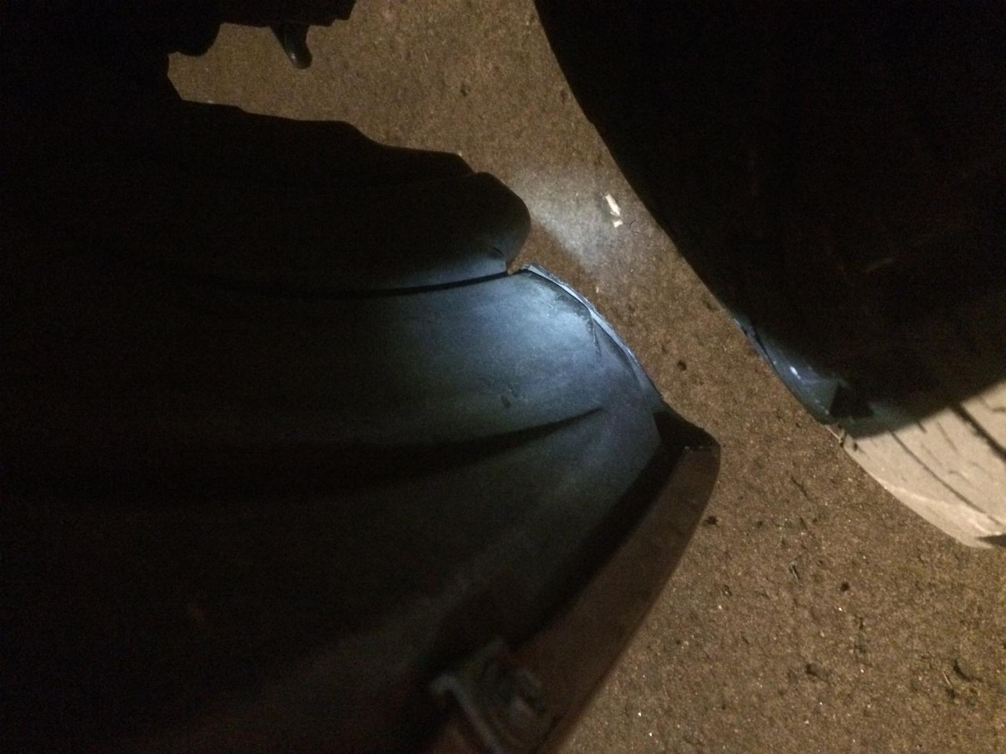

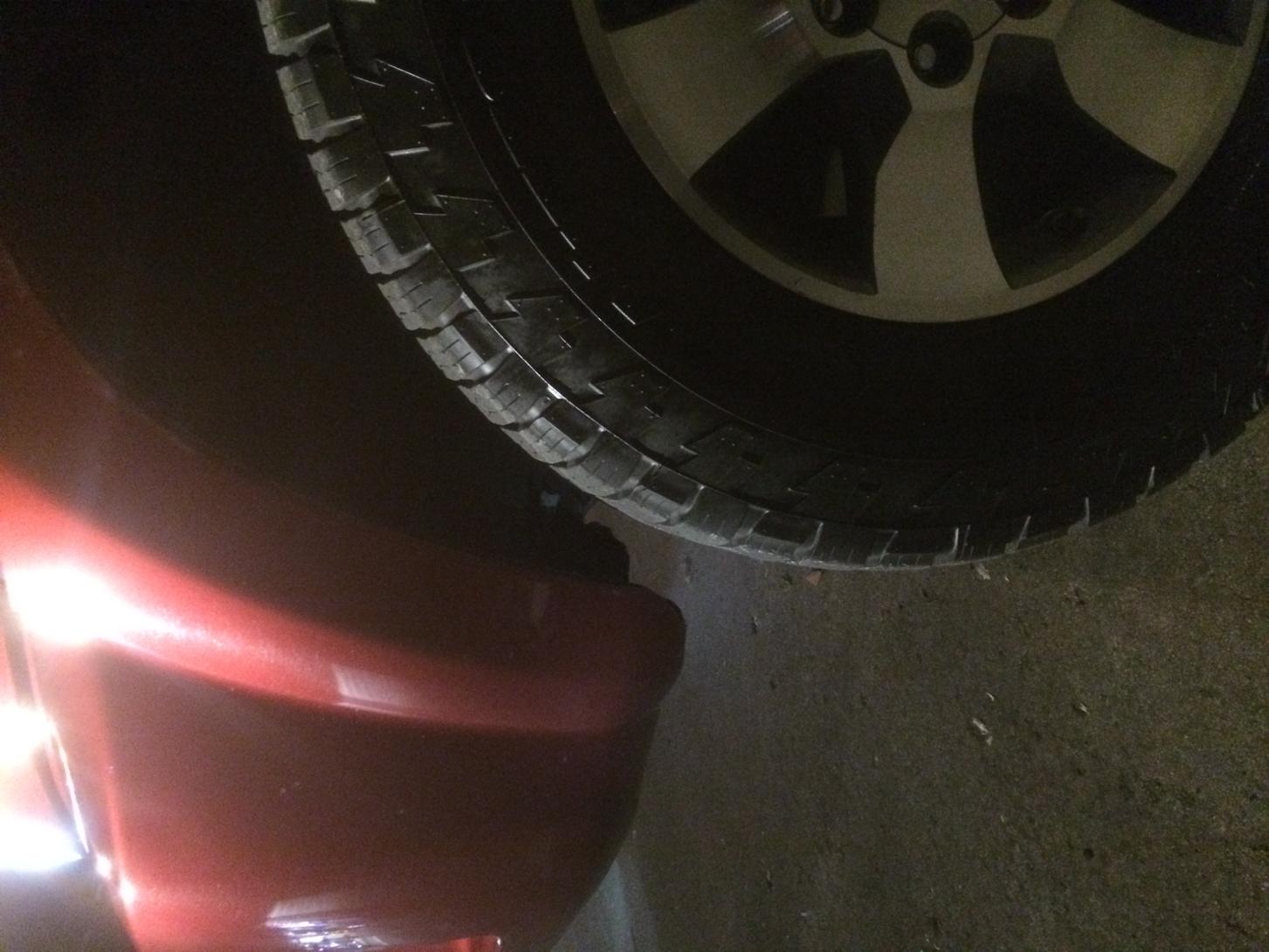

Seems like I've hit the point where the bumper clears. The liner still runs subtly in reverse at near full crank, but I think I "fixed" it.
Looks like this on both sides now. You can't see it from the outside, but under the well it's fairly evident it has been monkied with. :)
take a straight edge and razor that straight across and it makes it near invisible to the average joe that it has been trimmed up. glad you solved the issue though. The noise will make you cringe every time even knowing its only plastic rubbing
Cringe is right -- especially when it's the bumper and not the liner. The liner rubs, the bumper vibrates and growls. Bad stuff...
I'll tidy it up later today. I made those quick cuts last night in 10 mins to placate the wife and stay out of the garage. She doesn't understand why an 'improvement' (which is how I pitched it when I replaced the wheels and tires, and added STs) makes more work necessary. ;)
