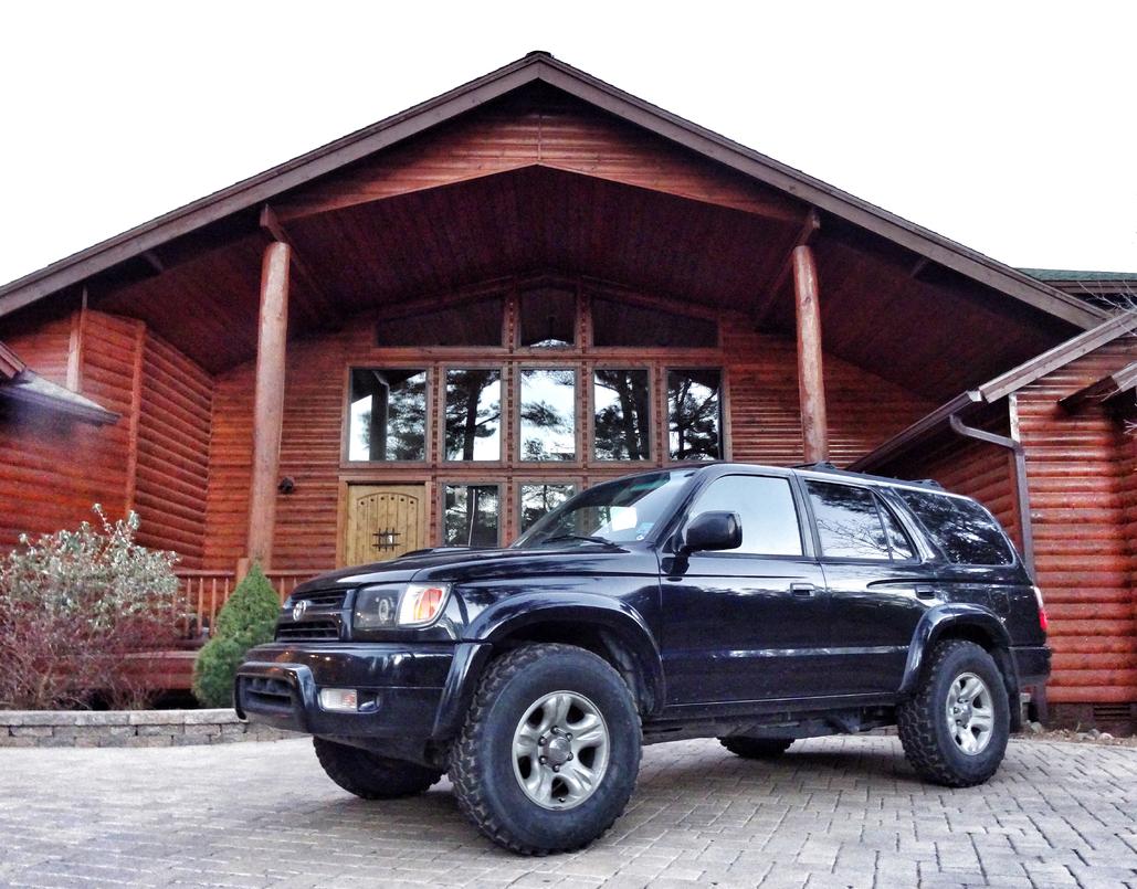

I finally pulled the trigger on a set of tires. I got lt265/75r16 bfg ko2s. I've only driven about 5 miles but I'm happy with my purchase so far. I noticed a slight loss in power, a slightly rougher ride, and a slight increase in noise but nothing to complain about. If anything, it rides more like a truck than it did with h/ts. It also feels more stable (could be the spc control arms I put in). The stance is great. The pictures on here don't give justice to just how aggressive the ko2 is. I'll report back once I get more seat time and when I get them off-road.
