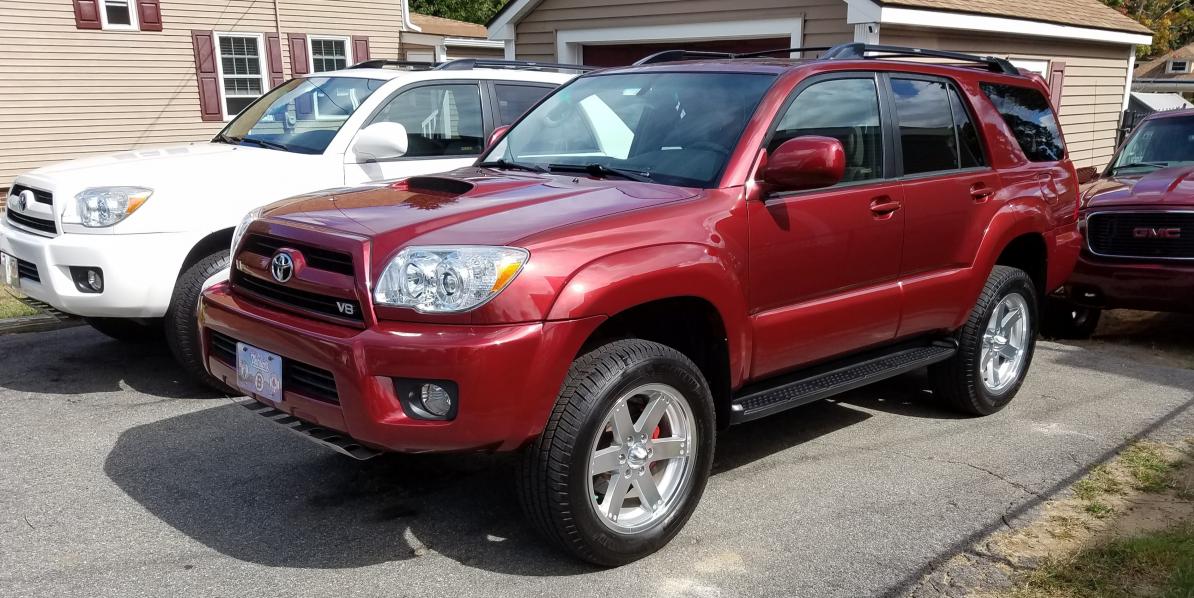

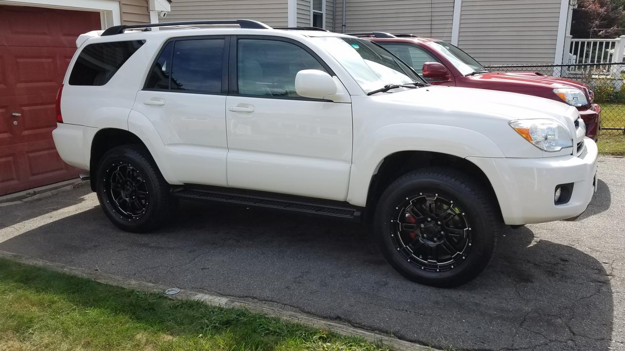

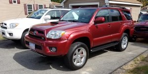

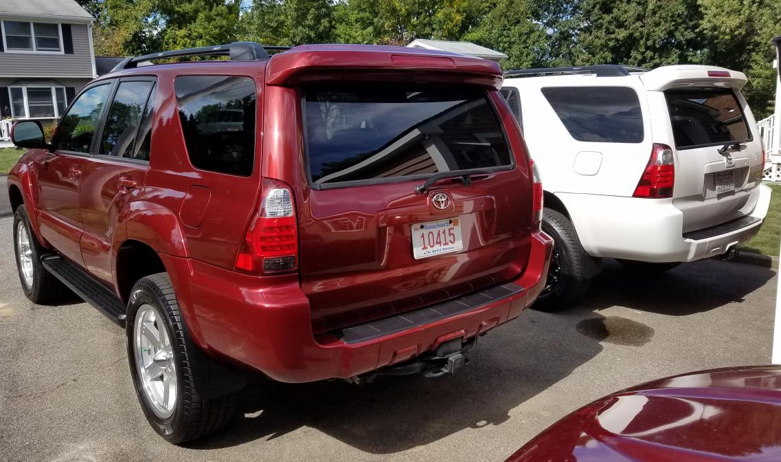

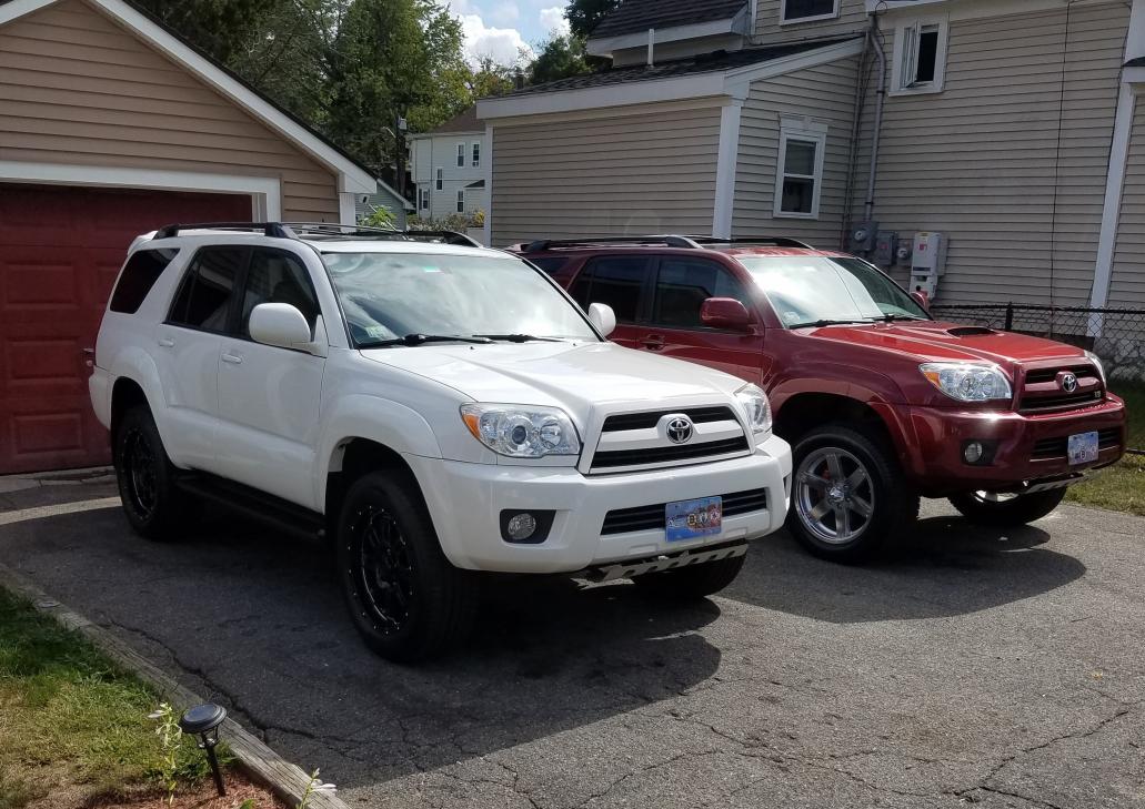

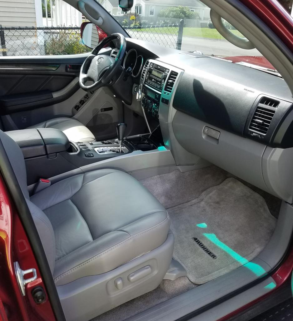

I thought I would show the two builds of my 4runners, there is still some things I want to do.
The red one is a '06 limited v8 with Bilstein 6112s at 2.5, rear 5160s with t14 rear springs, 4runner xsp wheels with Michelin defender 275 55 20 and a few added extras.
The white is a '08 limited v6 with a 2.5, 1.5 lift, 4runner xp wheels, Michelin XLT AS 275 55 20 and a few added extras.

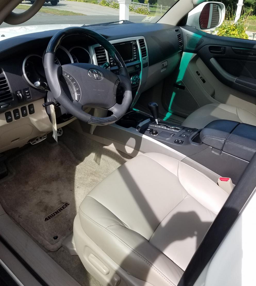

Thank you. I usually clean both of them thoroughly once a year.
I use a cleaner called LA's totally awesome cleaner( you can get it at a dollar store for less than a dollar), i use a dual sided finger and nail brush so i have more control of it, and i use surf city voodoo leather rejuvinator for the leather and vinyl. Sometimes i use resolve on the carpet in a pinch.
Here is a trick for all of you if you did not know already. On the plastic areas on the doors, cargo area etc if you have scrapes, plastic discoloration where the plastic has white spots, get a heat gun, hold it back about 6-8 inches from the panel, go back and forth over the area, do not hold it in one spot! Give it about 30 seconds to a minute or two and the damage will disappear.
