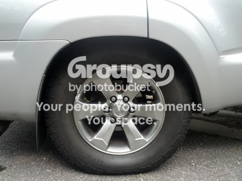

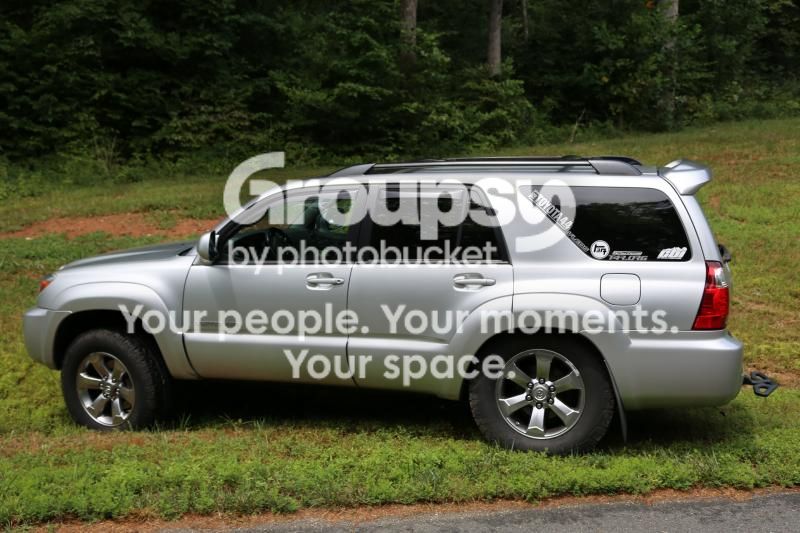

I ran 275/65/18s. Without a lift, I'd imagine you'd need to remove the mud flap and move the front inner fender liner. I ran mine with a 2.5 inch lift. You can check my build thread for pictures.
Another option is the 265/65/18 size, those won't rub on stock height.

IMG_20140321_130934_zps733424ce.jpg~original
IMG_20140321_114815_zpsa81cb6e7.jpg~original
5P8A0714_zps628baa67.jpg~original
IMG_20140518_150306_zpsd39768aa.jpg~original

With a 2" lift i still get a little rub on the front fender at full lock, but it fits.
I would actually be a little cautious about the wheels backspacing and how close that tire is going to be to the upper control arm with a 275.
