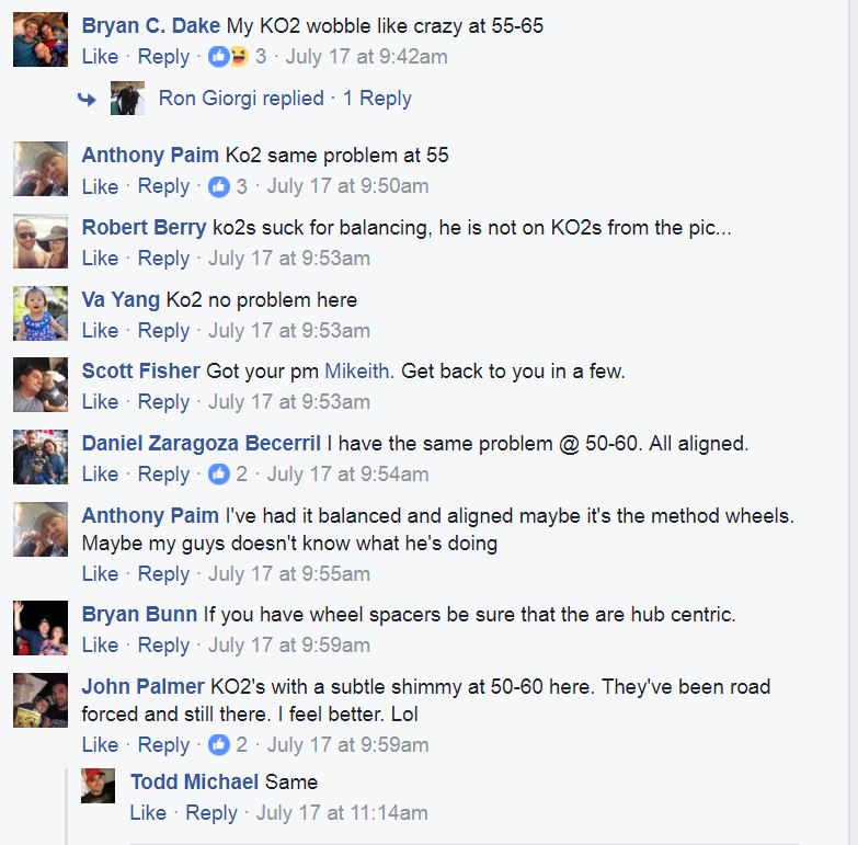

I see a lot of people complaining about Ko2 and shake.... seems to be common.
Quick screenshot I just grabbed from FB.....below...
Each batch of tires is different.. and it depends on where you buy them as to how good they are. The discount shops get the crap ones that are out of round. If you want a really smooth tire.. get Toyos....Heavy... but smooth as silk.
