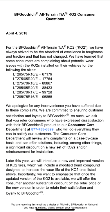

I wonder how much of this has to do with BFG KO2 tires. I've attached an email that went out to BFG dealers, and yes the tires mentioned seem like a small sample, but it does make you wonder about bigger issues besides premature wear that may affect a bigger population of KO2s.
